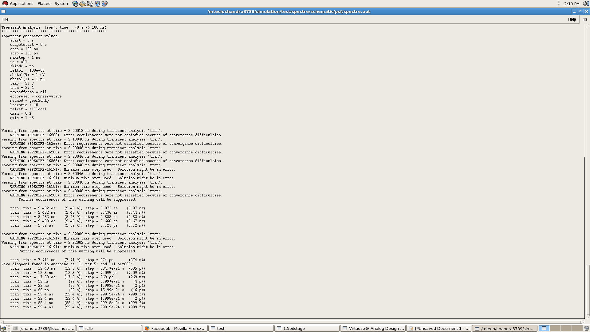

when i simulated it by changing the tran analysis mode to liberal then it showed the error
"no convergence achieved with the minimum step specified. Last acceptable solution computed at 21.004ns"........!
---------- Post added at 11:26 ---------- Previous post was at 10:56 ----------
also is shown "zero diagonal found inside the jacobian at net 12 and net 15".....what does that mean?

The errors you are getting are from lack of convergence during tran, the nets implicated might be a good indication of where the problem lies

sir this is the error i am getting....
---------- Post added at 12:22 ---------- Previous post was at 12:19 ----------
i did not give any accuracy settings.........the main question is if all those things matter why didnt the error showed up for two stages....
in the errors it is shown zero diagonal.....like this......

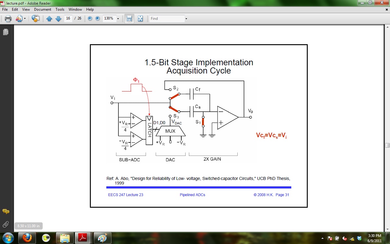

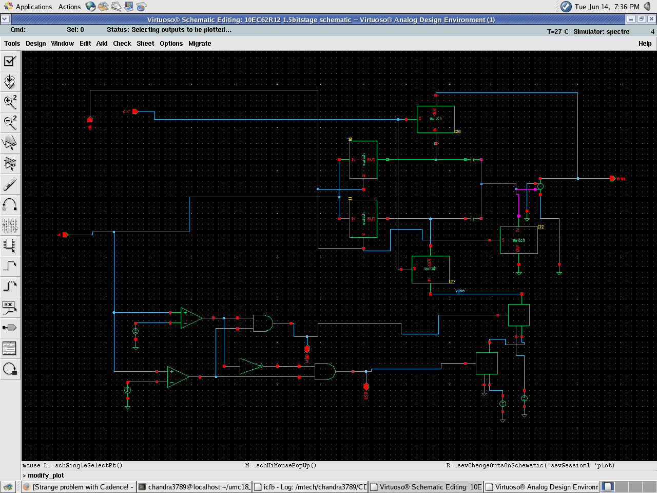

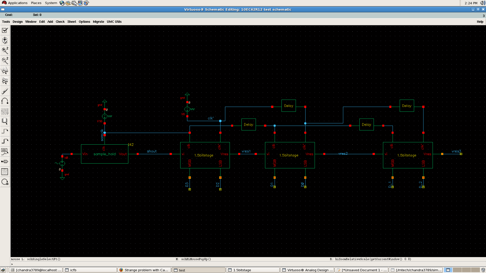

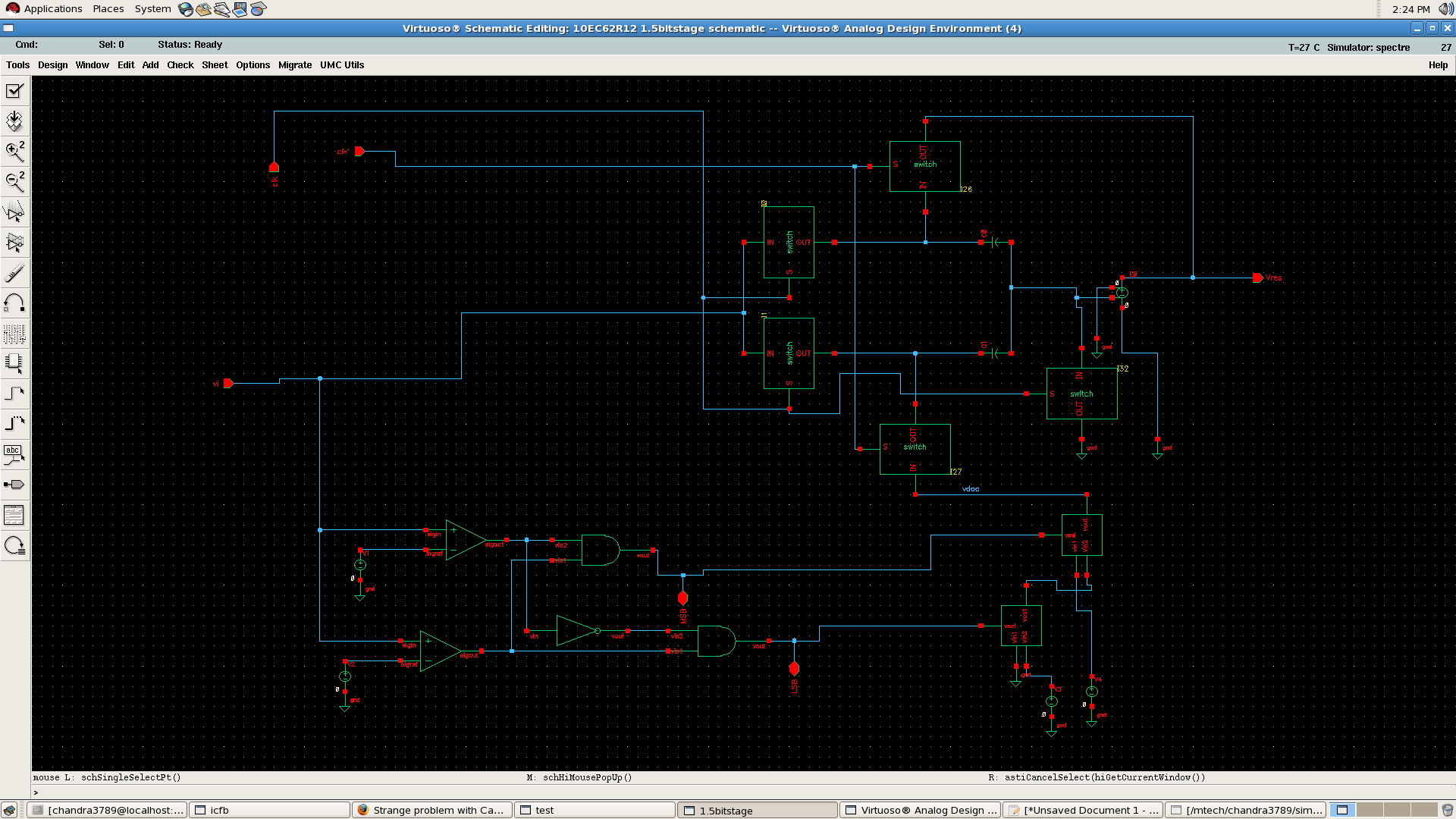

the schematics i am using for 1.5 bit/stage and test are........
what are those delays at the top? shouldn't clk become clk' of the following stage and viceversa? I understand that when one stage is in acquisition the following one is in conversion and viceversa, correct?

The problem is with net 12, net 15 and net 78 in the 1.5bit stage schematic.......
net 12 and net 15 are the wires which connect the left plate of the capacitors to the switches and net 78 is the wire which connects their right plates......
yes sir you are right....for reducing the latency by half we can drive consecutive stages by alternate clocks.....sorry i did not check that while reading the literature.....
ok then i would change it and see if the same error comes again.....
i did simulate with two stages with alternate clocks.but this time the error has shown up with 2 stages itself........

convergence failure in net 15 and net 60.........those nets are....
the nets that are shown in green and red kin colors connecting to the capacitors.........
