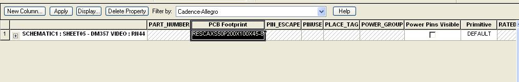

DSN file is the schematics file.
In shchematics you have to enter PCBFootprint form Editproperties (pictures attached).
Now from tools -->create netlist ,create netlist for PCB editor. ( 3 files - pstxnet.dat,pstxprt.dat,and pstchip.dat-will be generated)
This netlist can be imported to allegro.

*.dra is the footprint file.
while assigning footprint in shematics you can exclude the extension .dra
(for eg let your footprint is R0805.dra but enter R0805 in schematics)
