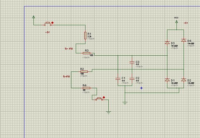

HI all i have some problem now i am using the some reference design for temperature measurement.I attached the signal conditioning ciruit part which i am using for rtd and thermocouple.
this is working fine in different input connector(screw terminal) ,no I want to modified it with single input connector,means user can connect both RTD and Thermocouple in same connector.
As of now if i connect that way Thermocouple voltage divider resistor comes in a RTD case and it will change the RTD resistance.
I am using rtd PT100 and K.j type thermocouple.

Not clear, what your actual signal condition circuit is, but you'll usually would need analog switches or a switchable current source to change the functionality of the temperature input

You'll need at least a switchable current source for RTD mode. To operate the RTD at a higher signal level than the thermocouple (less offset errors and noise influence), you'll also would want a variable gain amplifier.

here circuit i am working on now i tested with it thermocouple and pt 100 rtd its working fine but i want to add also pt 1000 with same signal circuit.I need to change the value of 2.2k(R1) resistor for pt 1000 rtd but i dont know how i can do it?

What's the exact problem? You'll either need switchable series resistor/current source or switchable gain to support both RTD variants.
