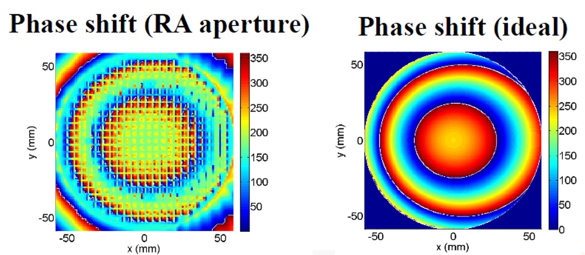

Hi brothers
someone here should help me as i m stuck for last 30 days trying to solve out 1 problem with reflect array in getting Reflect Array phase plot within CST but unable to find the way..
https://obrazki.elektroda.pl/6965314600_1372344054.jpg
phase of whole RA with Element position plot, u may have viewed in many research papers, which i need to know how to get in CST. I hope a positive reply. Thanks
