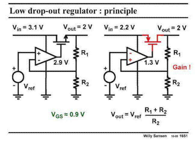

Sep 17, 2007 #1 L leonken Full Member level 3 Joined Jun 12, 2004 Messages 169 Helped 0 Reputation 0 Reaction score 0 Trophy points 1,296 Activity points 1,437 Two kind of regulators: NMOS pass device and PMOS pass device. Why the voltage drop across the pass deivce of PMOS is smaller than the NMOS? Added after 37 minutes: The figure

Sep 18, 2007 #3 W wwwww12345 Member level 1 Joined Sep 6, 2007 Messages 34 Helped 0 Reputation 0 Reaction score 0 Trophy points 1,286 Activity points 1,486 For NMOS, Vin >VG>VS(Vout)+VTN, so VDS=Vin-Vout>VTN, but for PMOS, no such formula is expected.
Sep 18, 2007 #4 L leonken Full Member level 3 Joined Jun 12, 2004 Messages 169 Helped 0 Reputation 0 Reaction score 0 Trophy points 1,296 Activity points 1,437 Because the Vdd(Vin) of the opamp is supplied by Vin. The output of opamp is less than Vdd(Vin).
Sep 20, 2007 #5 C chenmy Junior Member level 2 Joined Aug 18, 2006 Messages 22 Helped 6 Reputation 12 Reaction score 5 Trophy points 1,283 Activity points 1,460 Hi,Leonken: For NMOS , Vin is the supply of OPAMP,so Vin >VG>Vout+VTN should be met. so VDS=Vin-Vout>VTN (about ~700mV in 0.35um process) For PMOS,you only need to make VSD=Vin-Vout larger than Vdsat(usually about 100mV~300mV) So the PMOS LDO headroom is larger than NMOS LDO. It is the NMOS Source follower that reduces your headroom. Best regards! Chenmy
Sep 23, 2007 #6 leo_o2 Advanced Member level 4 Joined Sep 3, 2004 Messages 1,322 Helped 278 Reputation 558 Reaction score 241 Trophy points 1,343 Location China Activity points 5,761 Some LDO add a charge-pump and can also realize low drop-out with NMOS
Sep 25, 2007 #7 paley Member level 4 Joined Mar 3, 2006 Messages 78 Helped 6 Reputation 12 Reaction score 3 Trophy points 1,288 Activity points 1,596 because the nmos' Vgs
Sep 26, 2007 #8 M manissri Full Member level 5 Joined Apr 16, 2005 Messages 281 Helped 9 Reputation 18 Reaction score 3 Trophy points 1,298 Activity points 3,279 if u apply pmos pass devic the it will give u gain and phase shift of 180. when u use nmos as pass device then it will act as a source follower. so unity gain and no phase shift.

Oct 5, 2007 #9 J joe_chen Member level 2 Joined Oct 3, 2007 Messages 46 Helped 3 Reputation 6 Reaction score 1 Trophy points 1,288 Activity points 1,435 one is source follower and the other is simply common source stage
