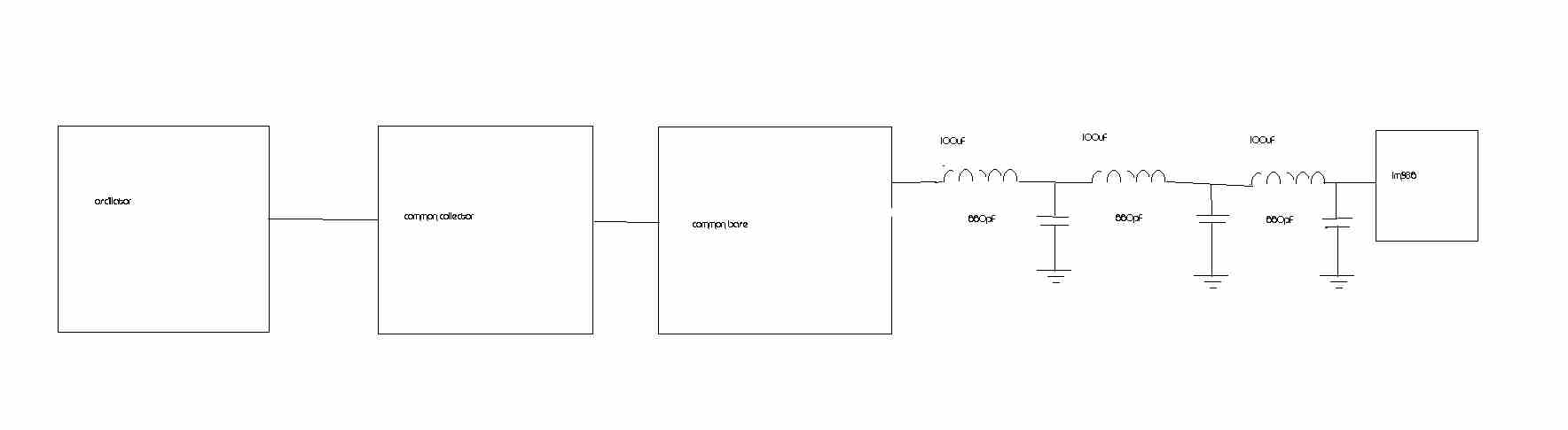

Here is a picture of the LPF:
For an audio filter that would (given the right values) be overkill. All you need to do is ensure nothing above say 20KHz gets into the amplifier. a simple RC filter would be more than adequate and eliminate the possibility of the LC circuit causing resonance problems when hooked up to the oscillator.
That's a huge jump from a TIP3055 to a 2N4401 but it should work much better.
Brian.
