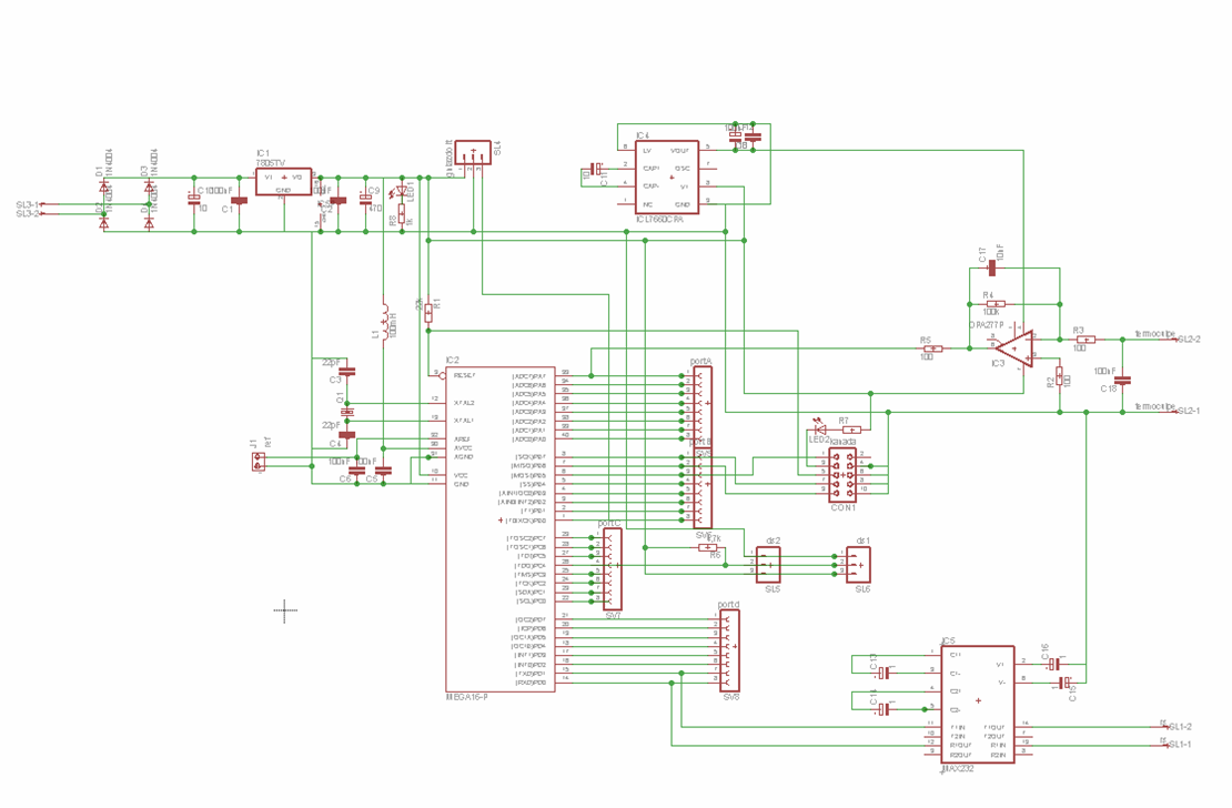

The presented project is the result of work on the quartz resonator in order to adapt it to measure various physical quantities. Using the system, you can successfully measure:
  • change of pressure in the range 10^-5 Pa to 3,5 bar
  • measure the temperature
  • measure weight gains (ng)
About the system:
Measure apparatus consists of two parts: a stable generator system and the system of collecting the data. The main task of collecting data system is to measure the temperature and oscillation frequency of the quartz resonator, and then transmit that information through RS232 port. Temperature measurement is realized by K-type thermocouple and digital thermometer DS1820, whose task is to compensate the cold end.
The whole device is based on microcontroller Atmega16 and programmed in Bascom. Specially written application for the PC allows you to collect information about changes in the frequency in the temperature function and imaging results.
