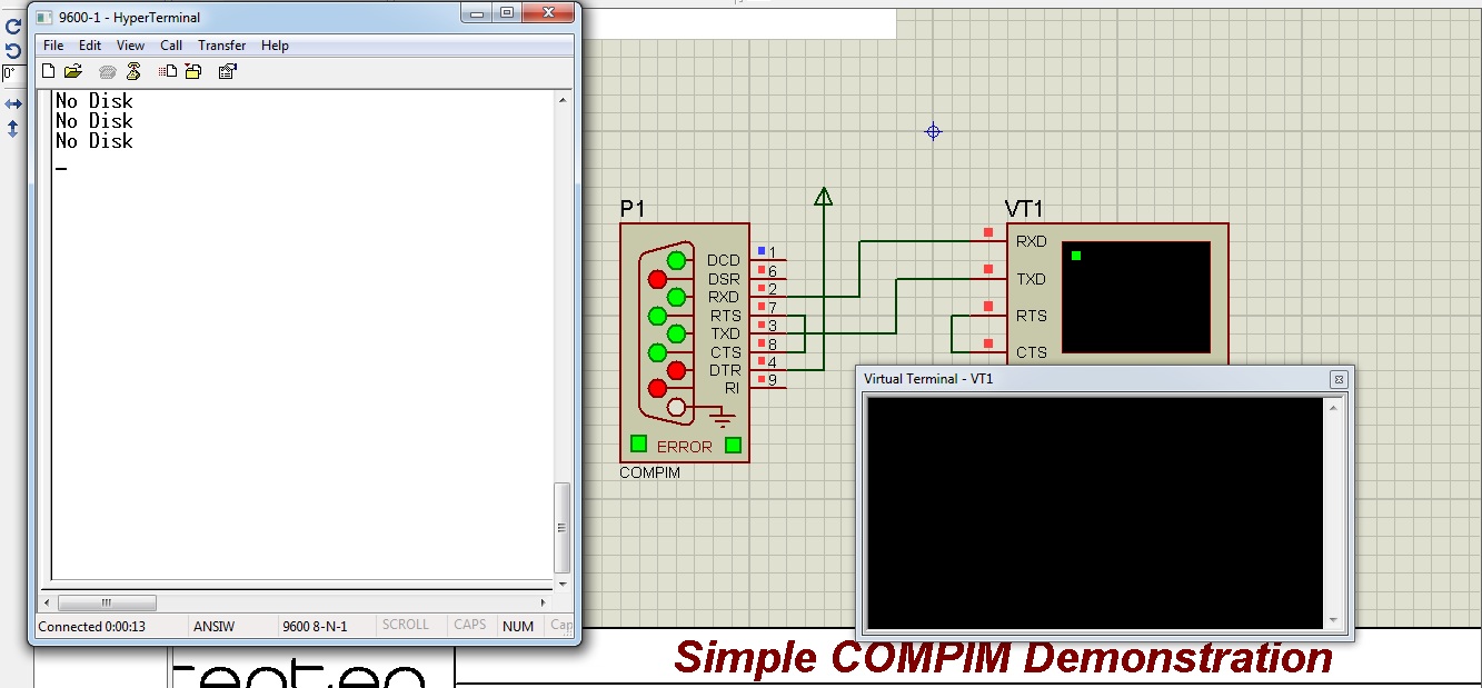

I wanted to connect my hardware to proteus through UART. I have used COMPIM DEMO model provided by proteus under sample circuit. I connected my hardware through Serial to USB converter. But i dint to get anything in proteus.
I just wanted to know whether the COMPIM works with serial to USB converter. Or do i need to make any change in settings for that.
I have verified the COMPIM demo model by using virtual serial port emulator. I typed in hyperterminal and got the same in proteus and vice versa.
But when i connect to my hardware, i dint get anything in proteus..
check the image for clarity.
With emulator
with my hardware
Please suggest.

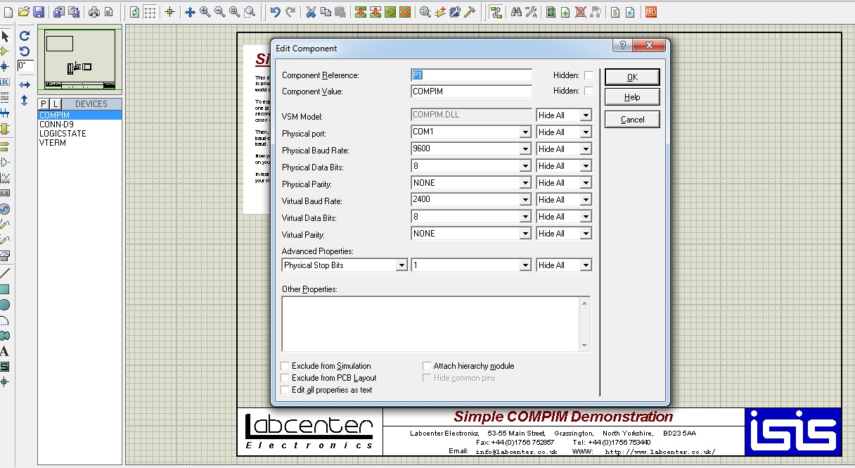

you have to set the baud rate of compim.right click on compim->click edit properties->set the physical port,physical baud rate and virtual baud rate.
I have set the baud rate to 9600.. check the image for setting..
if you have opened any other instance of COM in parallel then compim doesn't give any warning it simply dont work
I have assigned COM1 in proteus for COMPIM.. and assigned COM1 for my hardware through device manager(refer image showing serial to usb converter connected in com1). and no other COM1 port run in parallel...

Yes i am able to send data from pc using hyperterminal to my hardware. Refer my second picture which shows "No Disc" in hyperterminal, which i got from my hardware. and regarding "communication program using VB.Net" suggest me some reference as i am new to that.

Problem Solved ... I used Virtual serial port Emulator and mapped my physical port where my HW is connected to virtual port where my proteus COMPIM was connected...
