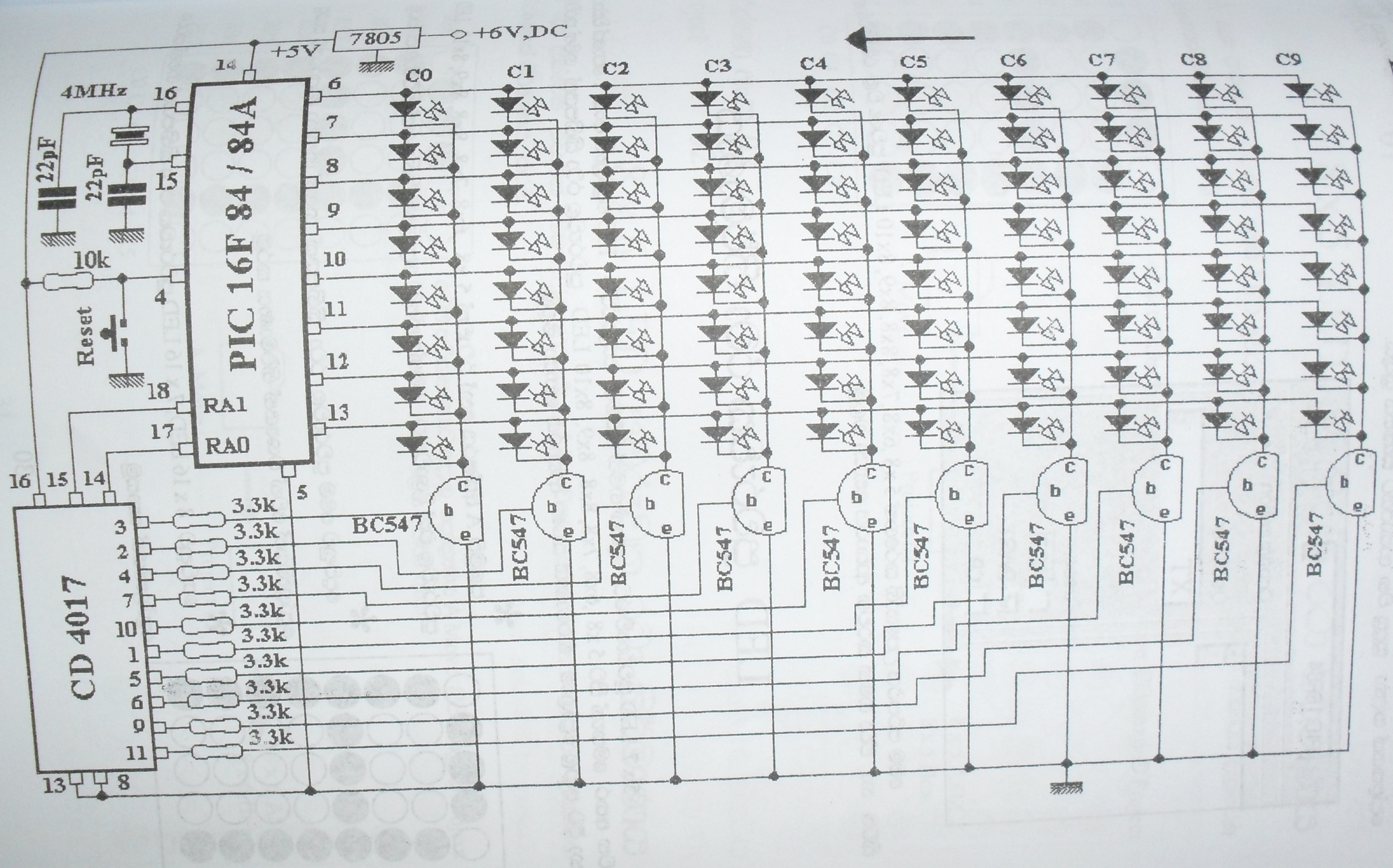

what's wrong with this program? if i build this on the MPLAB.. the result is failed... why? there's one error... i don't know where is the error.. pls help... me.. this is a 8x10 Led Dot Matrix.. that display... AMATURE RADIO TRANSMITTER CIRCUIT... pls help... i copied this program on youtube.. im a new to this program... the pic that i used is PIC16F84A...

what is the dollar sign mean? is it a character in the program? thanks for the help...

What was the error message from the assembler???
The $ sign means the current location, the pc value.
GOTO $-.2 jumps back two locations.

have you added the assembly program you write to the project?
just copy/paste the error message you saw on MPLAB will make things easier to understand
ml
In Mplab, try selecting the option
Project/Set Active Project/None (Quickbuild mode)
Then try to assemble again.
Error - section '.org_2' can not fit the absolute section. Section 'org_2' start=0x00002007, length=0x00000004 errors : 1
Get rid of the 'GOTO MAIN' at the very end of the program. You don't need it.
The reset vector is at 0.
Address 2007 is the configuration register.
Reactions: jabern

that is a 10x8 dot matrix schematic diagram.... pls. help us to make it 30x7 that display ON-AIR and OFF-AIR.... and using a selecting switch by displaying ON-AIR if it is "On-Air" and selecting the switch again to display "Off-Air"...
This an Example of the display 10x8 Dot Matrix That Display AMATURE RADIO TRANSMITTER CIRCUIT.. this circuit gave to me by the friendly man on youtube.... thanks! anyone there.. pls. Help us on our Project...
