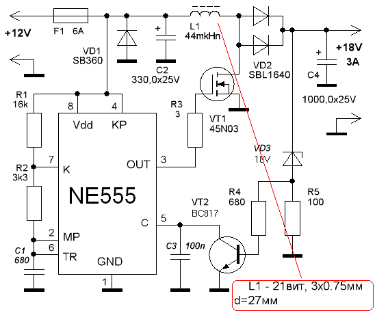

Are you suggesting that I am trying to run the chip at a frequency that is too high to be reliable? If so what is the most often used frequency range for this chip?
The inductor is from the power supply section of a tv circuit board and has quite coarse guage wire. I would have thought that it could handle a few amps.
