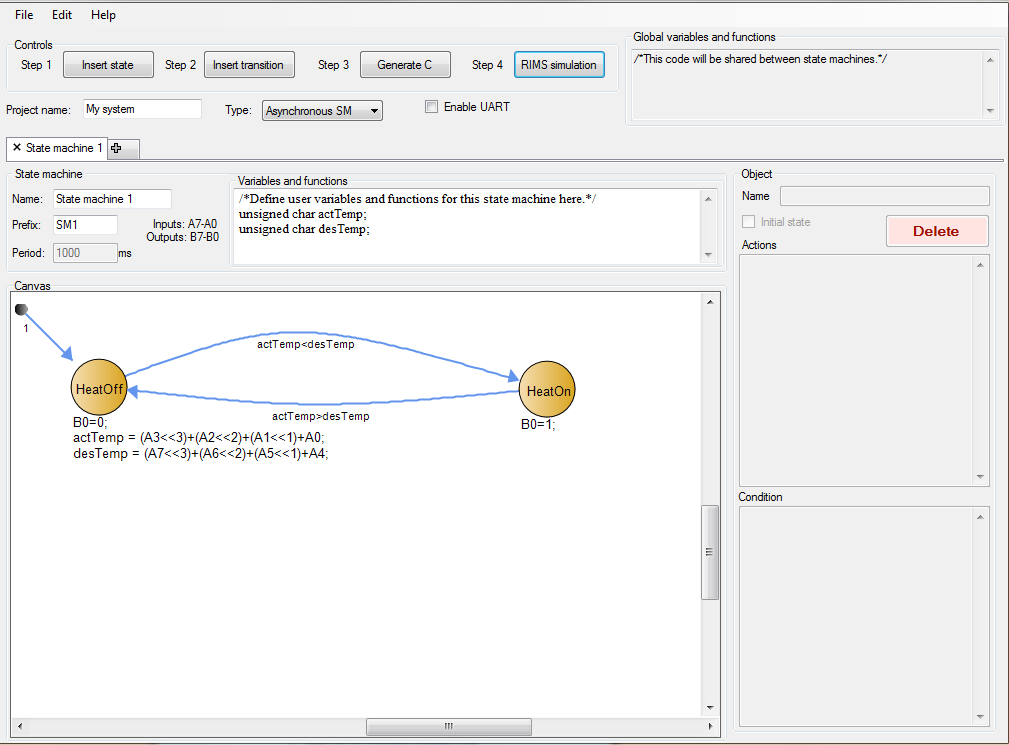

Hey everyone. This week I need help programming a heater. Here's the homework:
#1 A portable electric heater system should turn on heat (B0=1) when the actual temperature (A3-A0)
is less then the desired temperature (A7-A4). To let users see that the heater is on, the system should
blink B1 on for 500 ms and off for 500 ms. Capture the system using multiple tasks and a shared
variable.
Right now I'm working on turning B0 on and off. Here's my state machine and code:
This code was automatically generated using the Riverside-Irvine State machine Builder tool
Version 2.7 --- 10/2/2014 17:5:26 PST
#include "rims.h"

unsigned char actTemp;
unsigned char desTemp;
enum SM1_States { SM1_HeatOff, SM1_HeatOn } SM1_State;
TickFct_State_machine_1() {
   switch(SM1_State) { // Transitions
      case -1:
         SM1_State = SM1_HeatOff;
         break;
         case SM1_HeatOff:
         if (actTemp<desTemp) {
            SM1_State = SM1_HeatOn;
         break;
      case SM1_HeatOn:
         if (actTemp>desTemp) {
         break;
      default:
   } // Transitions
   switch(SM1_State) { // State actions
      case SM1_HeatOff:
         B0=0;
         actTemp = (A3<<3)+(A2<<2)+(A1<<1)+A0;
         desTemp = (A7<<3)+(A6<<2)+(A5<<1)+A4;
         break;
      case SM1_HeatOn:
         B0=1;
         break;
      default: // ADD default behaviour below
      break;
   } // State actions
int main() {
   SM1_State = -1; // Initial state
   B = 0; // Init outputs
   while(1) {
      TickFct_State_machine_1();} // while (1)
} // Main
Right now I'm having trouble getting from HeatOn to HeatOff. When actTemp is less than desTemp, the heater turns on, no problem. But when actTemp is greater than desTemp, the heater stays on. Thanks in advance for any help.

Well not being a software engineer...
I did notice your state machine doesn't tell what your supposed to do when you are in the HEAT OFF state and actTemp >= desTemp also when you are in the HEAT ON state you don't specify what to do when actTemp <= desTemp.
At least in hardware design done in Verilog/VHDL you would have to specify both those conditions.
