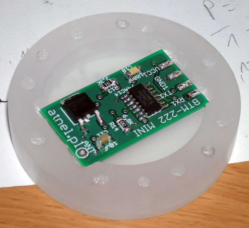

If you want to add synchronization of time with server/time models SNTP on the Internet, you have to provide communication with the PC. This communication can be completely wireless when you use BlueTooth – module BTM-222.
More information on such modules:LINK.
It was placed in plexiglass, because metal housing would interfere the transmission. You can also put an antenna outside and do not use plexiglass, although it is better to hide the antenna under the module in the plexiglass which additionally disperse the LED light.

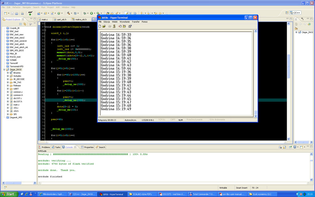

Connection with BlueTooth module in windows terminal:
