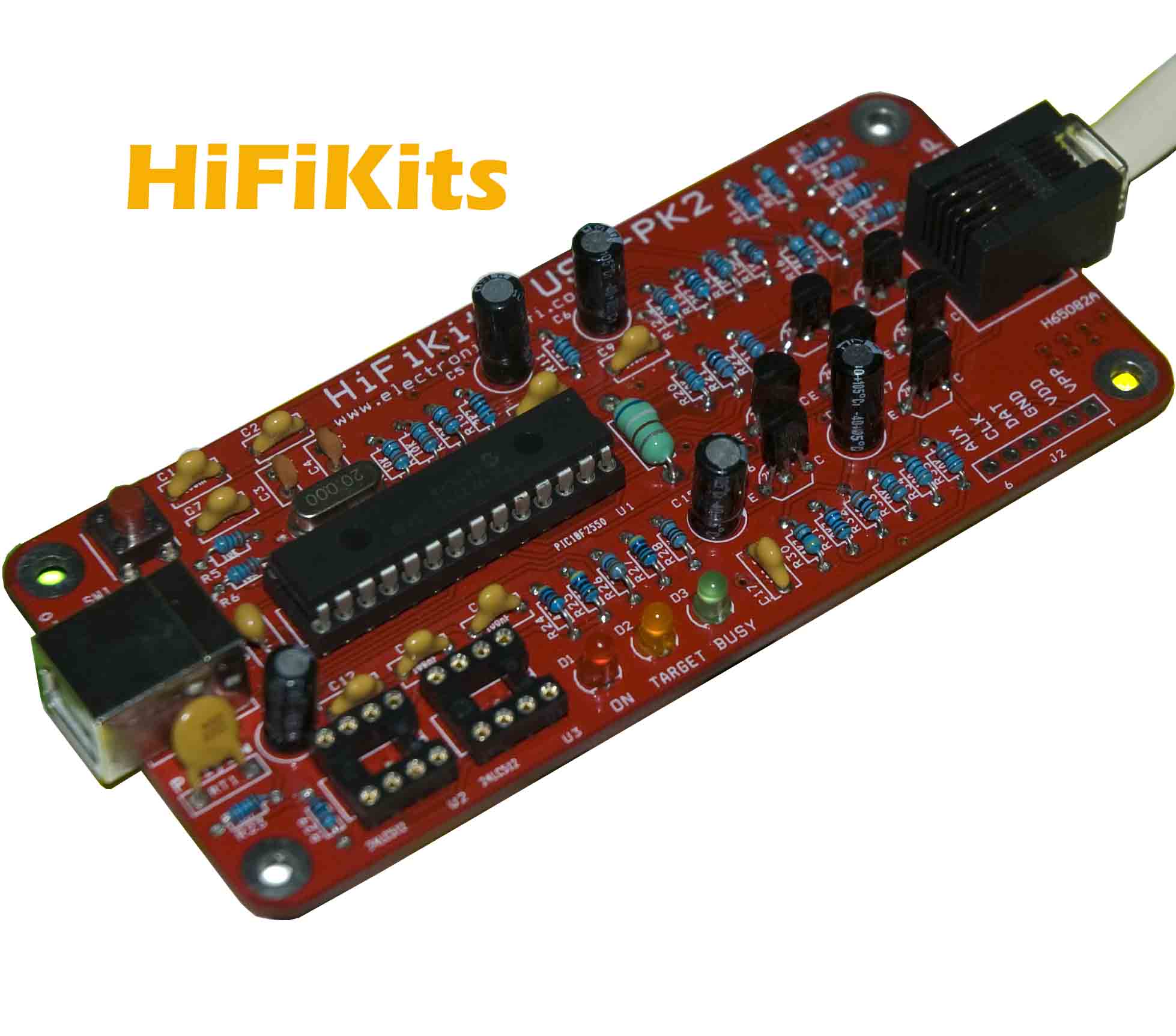

Hi friends
Please check our PCB for PICKIT2, only uses SMD parts for FDC6420, ZHCS1000,IRLML6402, BAT54, and MCP6001, all other is DIP, of course, the PCB, was made for comercial use, and made for electronicahifi in Peru
