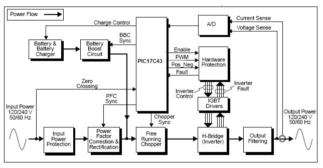

Hi, I'm new here. I need some help... I found this on the net, PIC based uninterruptible power supply, it uses PIC17C43. I'm going to modify it using PIC16F877A. I just need the schematic and layout of it. Does anyone here have a layout of it or knows how to layout this one? Kindly post it here and thanks in advance.

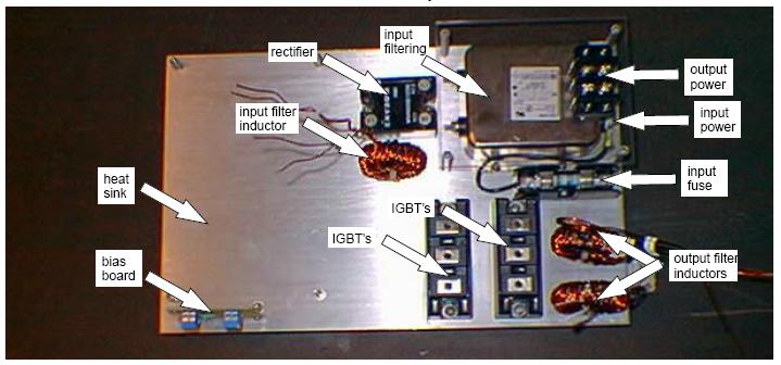

Demo Partial Assembly - Top View
