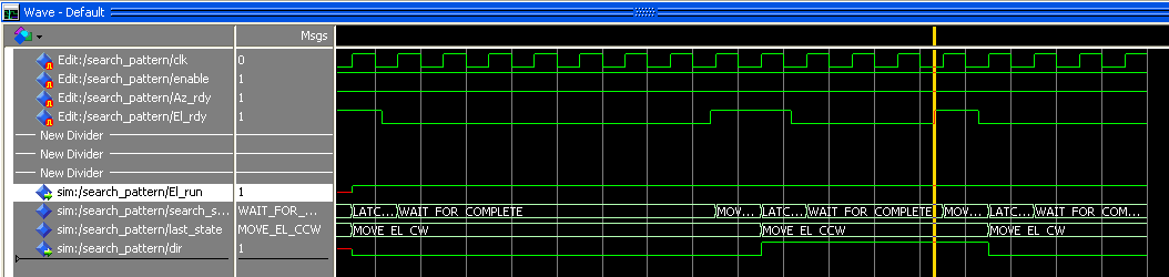

Update:
I simulated the design in ModelSim. The states are changing as expected and when expected, and the 'dir' output is apparently changing when instructed to also.
I still don't understand why I can't see this change outside of the component though. As well as feeding the motor driver, I have 'dir' linked to a board on the LED so I can see if it changes. Still no luck so far though...
Here's my modelsim output anyway, and the HDL for the other two components used
This is pretty straightforward really, just links the two components:

Update:
Is what you're simulating the entire design or just the module that you're having trouble with? If you're only simulating the module then it could be that you simply didn't connect the 'dir' output up to the top level of the design. Re-simulate to make sure that the simulation of the entire design works.
Assuming that you are simulating the entire FPGA design, then there are a couple possibilities, none of which has to do with the code...
- The 'dir' pin is mapped to a different pin than the PCBA has it connected to.
- The net on the PCBA is shorted
Kevin Jennings
You're correct, I was just simulating the one component to make sure things were working correctly.
I'll simulate the whole chain just now and have a look though.
What I do know, though, is that the hardware pin that 'dir' is assigned to does work. I reverted to a different project to check, and it seems to change/drive fine. The only difference (other than most of the program) is that it changes on the clock edge of a slower clock in that project. Don't suppose the clock speed could be an issue? It should still have about 0.1s between changing states while the motor moves anyway.
I think I've determined that the 'search_pattern' state machine doesn't enter the MOVE_EL_CCW state. My logic behind this is that the FPGA generally drives 'dir' with whatever value it is set to in 'MOVE_EL_CW', but doesn't change at all after that. This seems strange seeing as it operates fine in the simulation above.
Did you fix the sensitivity list that I think somebody pointed out earlier in the thread? Right now you have 'process(enable, Az_rdy, El_rdy)', but the logic as written says that it should be 'process(clk)'. Since synthesis ignores the sensitivity list, but simulation does not it can lead to differences between simulation and reality which is what you're seeing.
Kevin
Yeah, I had fixed the sensitivity list by the time I simulated it.
I'm working on simulating the whole chain, I'll post back here when I have some results.
