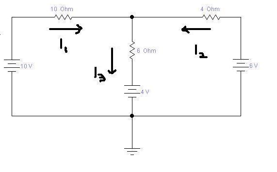

I always hate nodal analysis because it is your headache to point currents directions unlike mesh analysis.
I attached a simple circuit can you guys what will be current equation for this circuit?
It is very simply,
I1 + I3 + I2 = 0
(10V - Va)/10Ω + (4V - Va)/6Ω + (6V - Va)/4Ω = 0
And if we solve this we get
Va*(1/10Ω + 1/6Ω + 1/4Ω) = 10V/10Ω + 4V/6Ω + 6V/4Ω
Va*31/60 = 19/6
Va = (19/6) / (31/60) = 19/6 * 60/31 = 190/31
Va = 190/31 = 6.12903226V
Node voltage method : DC NETWORK ANALYSIS
Thank you very much but there is a confusion Kirchoff's current law says that current(s) entering into a node equal current(s) leaving the node.
In this circuit all currents are pointed towards same node but no current is leaving the node............
No confusion. Current entering the node is I1+I2+I3. Current leaving is zero. So I1+I2+I3=0.
The current directions are not drawn correctly but that doesn't matter because one or more will be negative when you solve the equations.

Here you have two more examples:
First
For this circuit from KCL
I3 = I1 + I2
(Va - 4V)/6Ω = (10V - Va)/10Ω + (6V - Va)/4Ω
And after solve this I get
Va -> 190/31 = 6.12903226V
Second
And again form KCL
(-I1) + (-I2) + (-I3) = 0
Or
- I1 - I2 - I3 = 0
So know all current flow outward (away) from the node.
So this assume that voltage at node Va should be at higher potential.
And current flow from + to - , I assume that if current entering into a node I give him " +"
and current that come out form the node I give "-".
But you can choose whatever you wont but you must be consistent in your choice
So I can write:
-(Va - 10V)/10Ω - (Va - 6V)/4Ω - (Va - 4V)/6Ω = 0
And again the answer is exactly the same

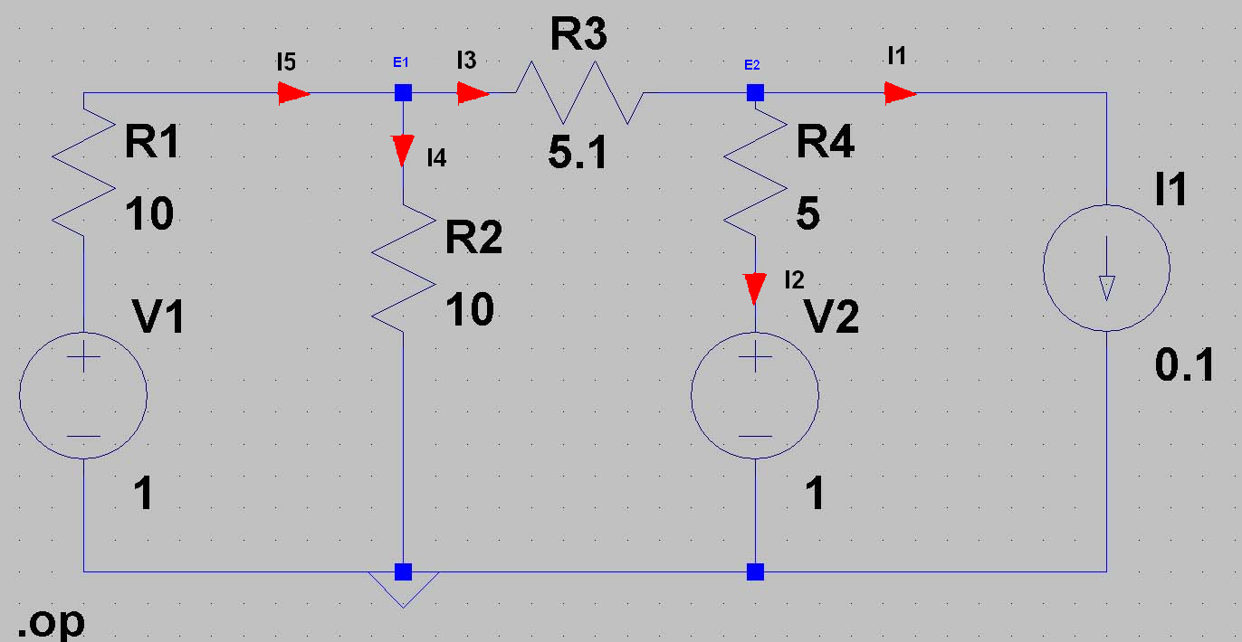

And maybe another example for this diagram I choose
So I can write
I5 = I4 + I3
I1 = I3 - I2
(V1 - E1)/R1 = E1/R2 + (E1 - E2)/R3 (1)
I1 = (E1 - E2)/R3 - (E2 - V2)/R4 (2)
And after solving I get
E1=0.5V and E2=0.5V
But I can choose that all current flow out from the node
Then
-(E1 - V1)/R1 - E1/R2 - (E1-E2)/R3 = 0
-(E2 -E1)/R3 - (E2 - V2)/R4 - I1 = 0
And again after solve this I get the same result.
