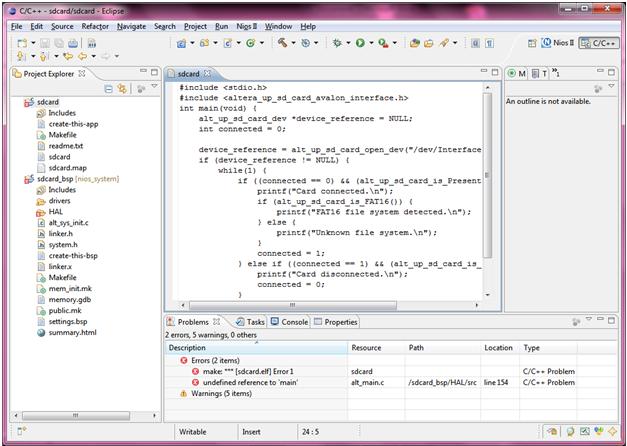

I studied using the SOPC builder and NIOS2. I made the projects in both tutorials provided by altera. Along the way, I encountered errors but I searched about them and found solutions. I made the tutorials worked on my board so I decided to try on the tutorial on sd card interface using SOPC builder. At the end part, for the software, I used the HAL device driver but when I compiled it, there were errors.
the last lines in my console are as follows:
C:\Users\Jackie\Desktop\sdcard\nios\software\sdcard_bsp/HAL/src/alt_main.c:154: undefined reference to `main'
collect2: ld returned 1 exit status
make: *** [sdcard.elf] Error 1
Do you have any idea on how to solve this? I already tried running my nios 2 eds as an administrator (from another forum’s answer) but it didn’t help me.

i guess it is linkage problem. bassically you need first to build (clean build) your bsp library (i see there is an x mark there) only then your project.
i did the clean build in my bsp library and it turned an error:

You don't have .c file with main function in your sdcard project. Simply add sdcard.c file with
#include <stdio.h>
int main()
  printf("Hello from Nios II!\n");
  return 0;
and check that this file is enabled for building with your project (after right clicking on this file you should see 'Remove from Nios2 build' string in the second position from bottom menu, else click to 'Add to Niod2 build'.
