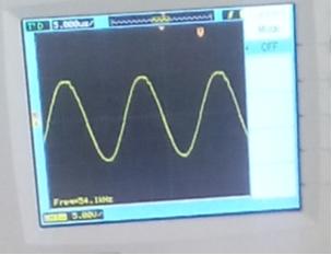

I am getting triangular wave using this circuit
The design of a lousy 741 opamp is 47 years old and was used for DC and low frequencies. At frequencies above 9kHz its high level "sinewave" output is actually a triangle wave because its output slew rate is too low.
Better and more modern opamps are perfect up to about 100kHz.
TDA2030A with Slew rate 8 V/µsec is ok for Sin wave upto 10kHz
The datasheet for the TDA2030A shows that it performs well up to 100kHz with a 4 ohm load and up to 200kHz with a load that is 50 ohms or more.
I don't recognize an obvious reason in the datasheet why TDA2030A won't work in this application. Although not discussed in the datasheet, there might be a problem that the amplifier isn't stable with closed loop gain < 3, as known for similar audio amps. But instability would show in high frequent oscillations rather than "triangle" waveform (you didn't tell the observed frequency). More likely, your circuit has wiring errors or wrong component values. Hard to debug from a distance.

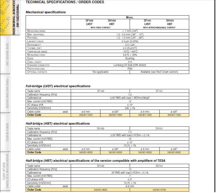

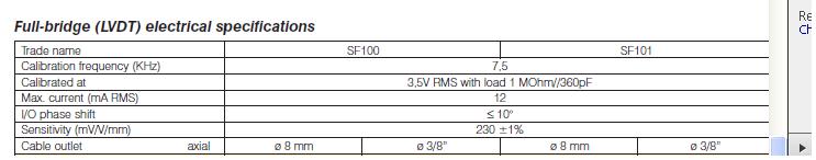

Unfortunately there's no driver coil impedance given, but 12 mA maximum is obviously the current specification.
I wonder where you got the 10 V rms driver voltage specification in post #5. I can't see it in the datasheet.
LVDT is just like transformer , can we calculate in put power, voltage and current , if we know output voltage and current.
