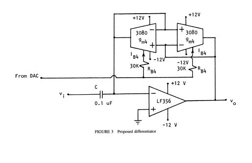

Need the circuit of differentiator using OTA

Can anyone give me the coircuit of differentiator using OTA.Thanx\][/b]

Found this obscure schem, I think the DAC input is the bias control, not too familiar with OTA's...
Good luck[/img]

Not obscure, here these ota(s) simulate a
controlled floating resistor.

Again not being familiar with OTA's how is this called a differentiator (title on the schem) ?

Thanx a lot for schem.but same here.its not clear how does this ckt works as differentiator. can't I get basic circuit for differentaitor using ota jist lik eintegrator in which just capacitor is used as load.plz anyone has basic diff.ckt ,plz provide
