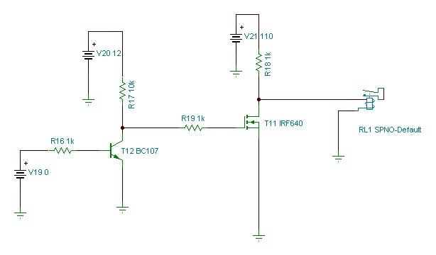

need help on Mosfet design suggestions
what is coil current of relay...?
because in your configuration I = V/R => 110/1000 => 110 mA. your current will be less than this value just make sure it is sufficient to energize the relay coil..
or connect the relay coil in series with mosfet as suggested before...

look for what we are discussing is Relay Switching using Mosfet so the load for Mosfet is Relay (Relay Coil).
the relay coil current shouldn't be 3A it should be the current of the load connected to relays NC,NO and COM terminals...
just check your relay's Coil resistance and nominal voltage and calculate the required current....

Actually my requirement is
Each output card drives 16 outputs through solidstate
FET switches. Each switch can drive typically 3 Amps from 110Vdc supply
for driving external relays. Again each of the switches is also provided with short circuit protection

your requirement is changing every time...
you should post a schematic or block diagram so that we can finally understand your application....
So here we are after 49 posts and we are still in point 0.
Now you tell us that you want solidstate FET switches (not relay as you said before) and in addition short circuit protection...

Introduction:
Each output card drives 16 outputs through solid-state FET switches. Each switch can drive typically 3 Amps from 110Vdc supply for driving external relays. Again each of the switches is also provided with short circuit protection so that in case of accidental overload or external short-circuit the switch is tripped to protect the switches.
Functional Description of the Output card:
The system has a provision for 80 digital outputs. All outputs are optically isolated. The system is a two out of two system i.e. two processor will work simultaneously and in case of failure of one the other will take the whole responsibility of the system.
Output data from the two-processor cards are first latched on individual buffers. This is crossed checked by the individual processor through feedback ports. The data is then passed through an OR gate to combine the activation signals from the individual processor. A second stage of feedback is provided from this stage. This ORed output is used to drive opto-isolators, which in turn switch ON the MOSFET for driving the external relay.
