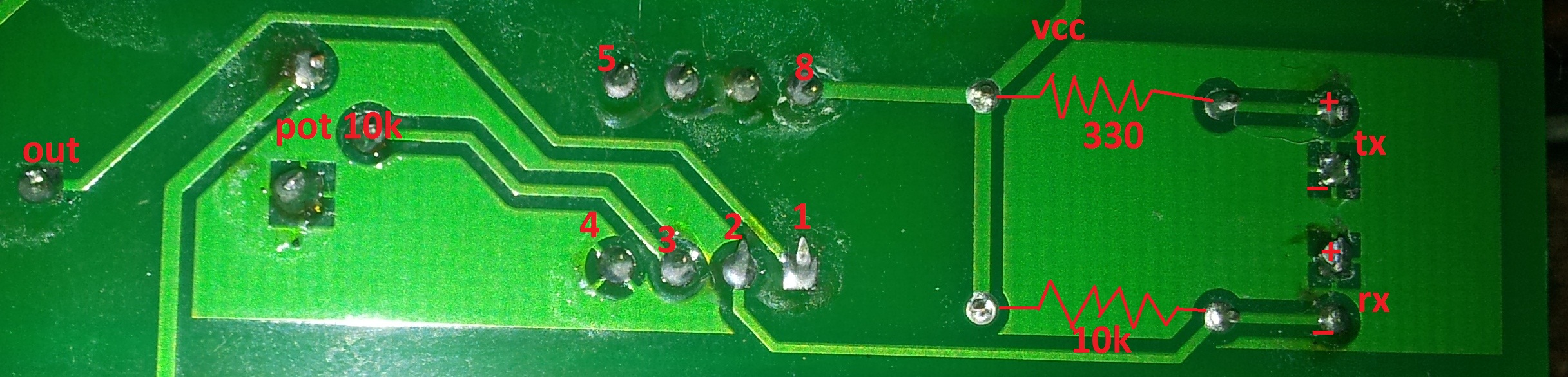

i am following a circuit of ir pair which i have seen in many tutorials
the circuit is given in the picture..i did followed same as the circuit but i dont know why its not working..
will any one please look at my circuit and just let me know where iam wrong..
the led connected is supposed to be off when some obstacle is in front of ir pair...

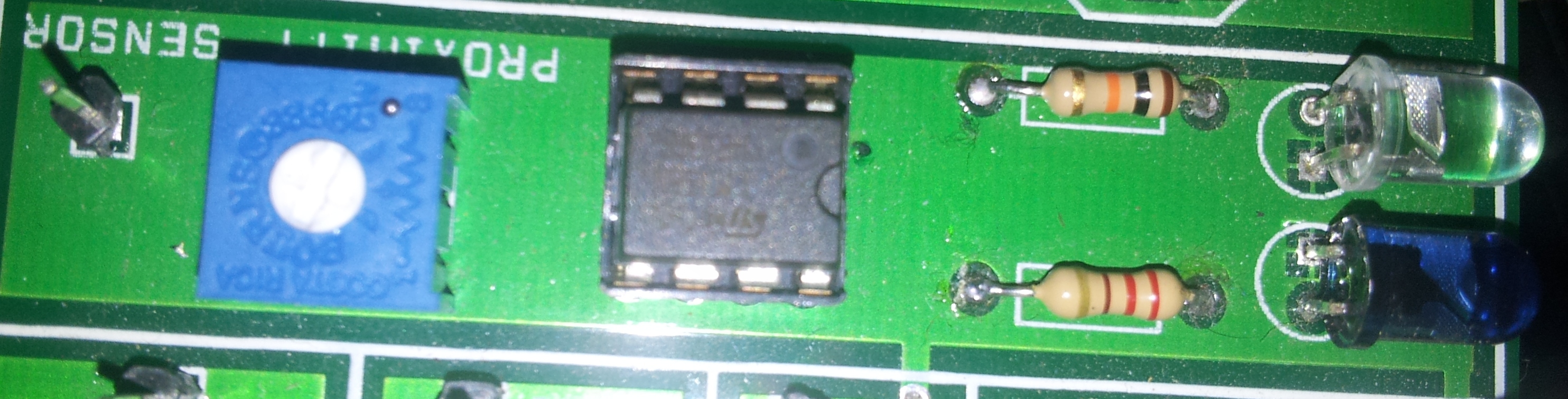

i have seen the same circuit i am following in a development board of arduino uno... and actually i have copied my circuit from there..
and its working fine there
look these are the pics of the board part containing IR pair ckt... and the ir pair on the board works fine the out is connected to the 1 pin of lm358... i also tried it but it doesnt work.. in fact once a time when i was doing on breadboard when i connect the out to 7th pin.. the circuit works... but after 5 minutes it does'nt
https://obrazki.elektroda.pl/3319459100_1417672702.jpg
https://obrazki.elektroda.pl/2422126600_1417672703.jpg
Yes the circuit is fine and should be working. I saw that in the schematic you posted in the first post said that 10K is connected to the TX which must be 330E. If thaz 10K the circuit will not work. Next the LED connected at the output will be ON when an obstacle is detected. check 5 volts at Vcc pin of the IC in reference to the GND pin. The most interesting fault i saw is that you are using IR led of different appearance and color (one is transparent and other is dark blackish green) in your circuit at both sides which will never work. The Photo diode will be full black and fully opaque. Install that and come up with results.

Like I said on the other website:
"The circuit schematic might work if the dual opamp is a TL082 that has inputs that work at its positive supply voltage.
The circuit does not have a 330 ohm resistor as you show.
I was correct, the Tx LED does not have low current from a 10k resistor, instead it has high current from a 220 ohm resistor."
