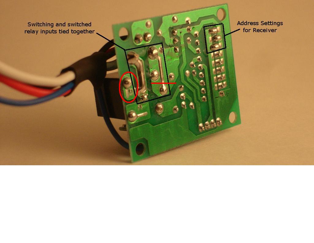

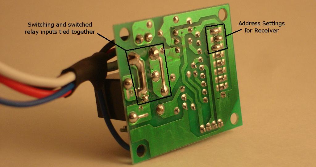

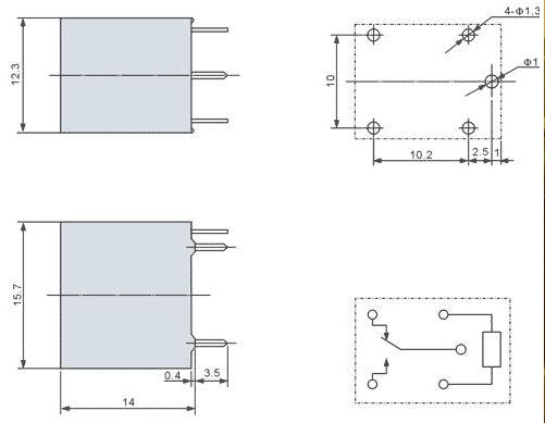

This switch uses a JZC-8FA(4181) PCB relay as the switch. My first question is this... if this relay is only used as an on/off switch... shouldn't I be able to wire in another wire so that it turns into an A/B switch? (See schematics... I am thinking that this relay has a common, a NO, and a NC... however only the NO or NC is being used right now, not both)
Secondly... this switch uses the same 12v input to power the receiver as it does to send power through the relay (switch). I want to isolate the relay power from the receiver power and simply solder in a second wire.

So I was hoping... by looking at the photos... I can get suggestions on where to place the wire to get to the "B" side of the relay, if possible? and were to cut board to isolate the power supplies for the receiver versus the relay?

PS. Please Note, photos have some notations on them because they are from another person, but this board has not been modified and is how it is shipped from the manufacturer.
Attached below is a picture of where I believe you should cut the foil to isolate the common node of the relay. The circle is the presently unused "B" side. Look closely at the bottom foil. The PCB designer provided an option to either have a normally closed relay or a normally open one. Both relay contacts are routed very close to the output terminal. The assembler selects which type he is making by placing a solder bridge between the desired contact and the output terminal. The is the reason they went with a SPDT relay.
