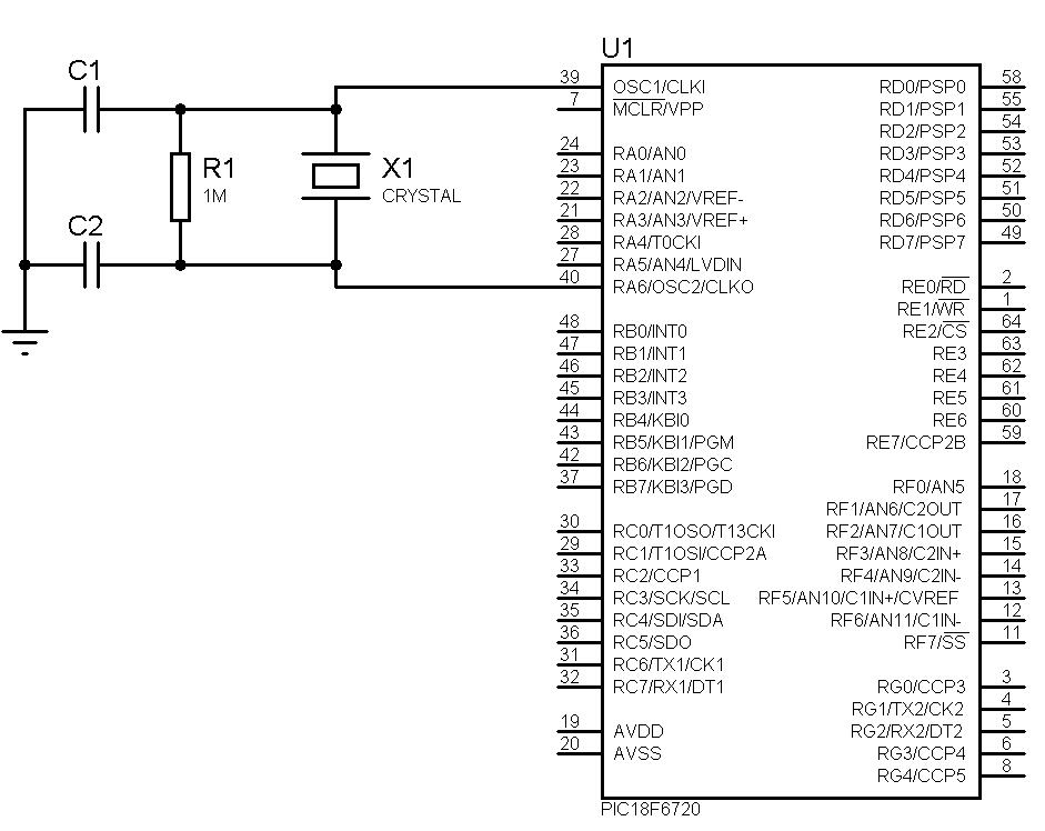

Can any one post an schematic based on 18f6720 including ICSP programming connection?
I want to use this IC with one of my upcoming project

Pgc
Pgd
Find the pin corresponds to the chip you want to use, it will be the ICSP pins
ICSP is properly attached but the crystal is attached as per attached diagram
which is different from your posted.
Is it ok with my crystal connection or you recommend to change it as per your suggested diagram.

but my loader ICD U40 r not detecting the microcontroller.
Probably the crystal is faulty or microcontroller is damaged during mounting
let me check with another microcontroller.
Thanks for your help
Now the controller is working, problem was with the connection and mounting of ic.
Anyway thanks for your help.
