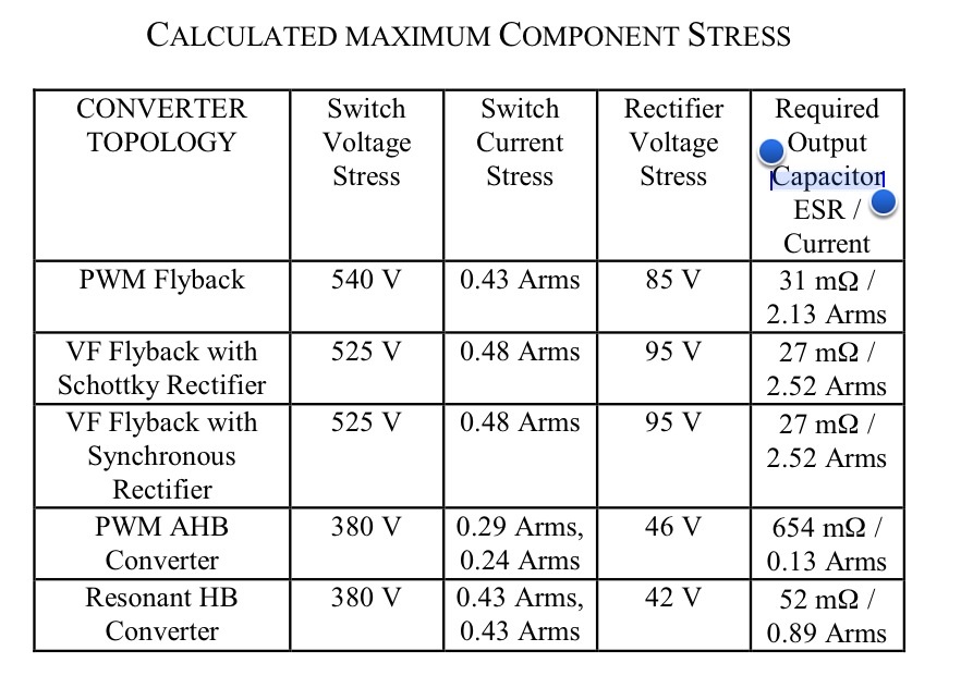

The following gives a good comparison for SMPS ESR and ripple current in an 85W 19V laptop charger.
image-jpg.92475
If you want a more reliable design specify the ESR in every component at worst case internal ambient and reduce the stress on the each part and measure peak and RMS current at max load conditions, and full step load.
Note the ratio of output current 4.2Adc to the ripple current above ( 85W 19V) and stronger consider an asymmetrical half bridge (AHB) design over the others. 0.13A rms secondary.vs 0.89 or 2.52A rms. AHB is only 2% ripple current for a resistive max load current.
But, your load is not resistive. What is the motor ESR?
