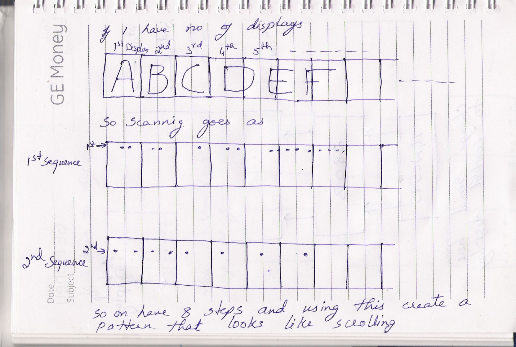

Hi tiwari.sachin;
Your experiment above is NOT a multiplexing circuit, so when all leds go on, the sum current is about 400 mA (10 mA x 8 x 5). Your power supply (as you wrote) is 9 v, so the 7805 is dissipating about 1.6 Watt ((9 - 5) Volt x 0.4 Amper), without any heatsink it will be very hot.
Use the row scanning multiplexing method:
Only one row (in this case 5 leds) switched on at a time, so the max current will be 50 mA in case of one 8x5 led matrix (or 800 mA in case of 16 led matrices). Do it (the row switching) fast enough to prevent any flickering. A 100 Hz rate is enough.
I recommended the increasing the led currents to 20 or 30 mA (determined with the current limiting resistors at the cathode side) for a well brightness. So the max current will be 1.6 or 2.4 A, but you have a 3 A supply.
Do not forget to apply a big heatsink for the 7805, or modify your circuit to supply the led anodes (via the PNP power transistors, 8 pcs) inmediately from the input voltage.

I have attached a pictorial view to clarify about the understanding.
I was trying to do it the otherway round and that probably would have had flickering effects. Your option seems more reasonable and a better design especially when 74HC595 can source only 30mA. It surely needs a lot of programming though.
Meanwhile, i have kept a single matrix ON (all LEDs as shown in figure before this post) for the entire day today and the 7805 didnot heat any further. Seems i will have to think about some power dissipation factors here because the final product will have more such matrix displays connected.
As far as PNP goes, TIP 127 should be fine. Do you have any other suggestions?

So if you will have 8 matrices (each 5x8), your pnp (or P-MOS) transistor will drive 8 * 5 = 40 LEDs (duty cycle 1/8).
I think you will write your first software to test 1 matrix so you can check the display brightness for the LED current you decided on.
When you will add more matrices, the only difference you will notice is that the voltage drop on the anode driver will increase which in turn may decrease a bit the LED's brightness (assuming your supply has enough power).
