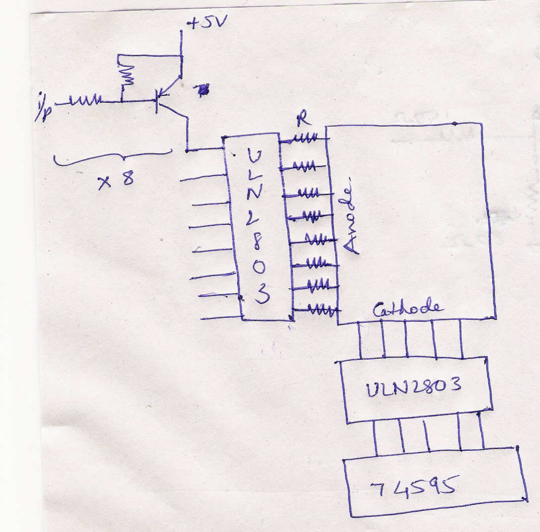

I am trying to design a matrix LED display using 5x8 ROW Anode display. I am not sure but i might be using 15 to 16 such displays for the initial version(ofcourse this can change as per customers requirement)
What seemed easy initially seems way too confusing now. I am not able to understand which are the appropriate ICs that i should go in for the design.
I have attached two possible design configurations for your reference. Kindly let me know which one is more feasible option. Or might be even a third option :)
I was initially told to use 74HC595 but i am not too convinced with it. I am not sure if it can handle the amount of current flow in worst, all LED ON condition.
I will surely not be driving all the LEDs at a time but then if its done, the hardware should not blow :) I want to surely have a very decent reliable hardware design.

74HC595 can provide a current of up to +-35mA, this is clearly not enough in your case because even if a single column turn on you will need more than that (assume that all leds of the column turn on).
You can either use discrete transistors to drive the leds or ULN2003/2803 to drive the cathodes and UDN2981 to drive the anodes

To drive cathode, i would be using a shift register (74HC595) followed by ULN2803 for each cathode line.
I am still thinking about what to use for driving anode. especially with such power hungry LEDs (rather group of LEDs)
You can simply use individual transistors to drive the anodes, it shouldn't be a problem.
If you want to drive them with low currents you can use darlingtons
Alex
Any suggestions of this
TIP127 along with ULN2803 for anode (Do I actually need ULN here)
74595 with ULN2803 for cathode
Apart from the fact that there is no reason to use a ULN between the transistors and the anodes there is also the problem that ULN2003/2803 have open collector outputs so they can't source current (drive the anodes), they can only sink current (drive the cathodes)

As posted before, I was trying to drive a single matrix display as for now by using a 74HC595 and ULN2803 for cathode and TIP127 for driving anode.
I am using a PIC16F873 for testing single display.
For power I am using a 7805 which can give upto 1 amp.
I find that the total current required considering each LED will consume 10mA, would be 8 X 5 X 10mA and should not go beyond 400mA but i find that 7805 starts heating when i switch on the LEDs.
I am unable to find the reason behind it. Can you give me some suggestions on the same. Input to the 7805 is a 9v/3amp adapter

The power consumption on the 7805 is 4v*current so it depends on the total current of your circuit, not just the leds.
Maybe total current is higher.
Alex

The schematic has 15 displays 8x5 each
Assuming that the multiplexing is done using the transistors in the 8 anodes (row 1,2,3...8,1,2,3...) then the max consumption can be one row on in all 15 display so 15*5=75*10mA=750mA
