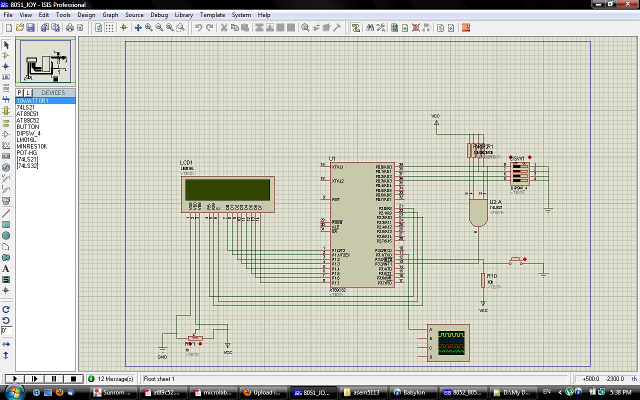

I change my code in some way, it is correct in PROTEUS but when I conncet it to LCD (JHD162A) I see many problems:
characters isn't correct.
I have 2 lines but on second line nothing is written.
checking busy flag does't work. I see nothing.
reset button on my 89c52 doesn't reset LCD.
and very serious problem, LCD is very dependent to power, I regulate power with capacitor and diode it got better but not solved.
also it is very dependent to the way i conncet power!
I try this on university with better equipment but I have same problem
please help me,is code correct?
and if it is correct why I have these problems with all LCDs?

LCDs require time to powerup in the real world, unlike a Proteus simulation.
Do you have a 100ms to 200ms delay before accessing the LCD at the start of your code?
Also post a schematic of your circuit, including your regulated power section.
Have you implemented the contrast control of the LCD?
BigDog
Yes I put 500ms delay before starting my work with LCD
I put schematic here, my power regulator is simple, must I have one in my circuit?
about contrast, I can adjust it very well with a pot
and another question, can I use one 12Mhz crystal to run 8051s? and how to connect it if your answer is yes

Add small delay between clr rw and setb e and clr e
you are getting garbage data on lcd or none at all? Is the first like complete black?
Also post the complete practical circuit that you have implemented.....
Not complete balck, it is random
sometimes I get what I want but after that garbage, e.g. "x=15y=15555555" 5s are garbage
somtimes all is garbage, e.g. "8888888888888888888"
and somtimes nothing appear
I post my circuit, first thing in my program is running LCD then waiting for interrupts, I connect ints to Vcc and also EA/VPP. XTALs are connceted with 30pfs and 12Mhz crystal. In the side of LCD I put a pot and can adjust contrast,all balck to nothing. This is my practical circuit for this part of my project.

Reading all the posts, i feel there is some other part of the program is making trouble.
Another chance is hardware error, Check for both
just write a simple code to display 'hello world' on the lcd and check if its working.......maybe your other code (interrupt) is causing some problem...
Your PIN connections are as follow:-
RS ---> P2.0
RW ---> P2.2
EN ---> P2.1
Pls check these connection whether u have write the program considering these pins or not...
As u have not defined your pin configuration in the code given above...
Kindly Check that and report us back....
And can u upload your proteus design by zipping it..
before Doing so check connection i have told u
Hope this assist
