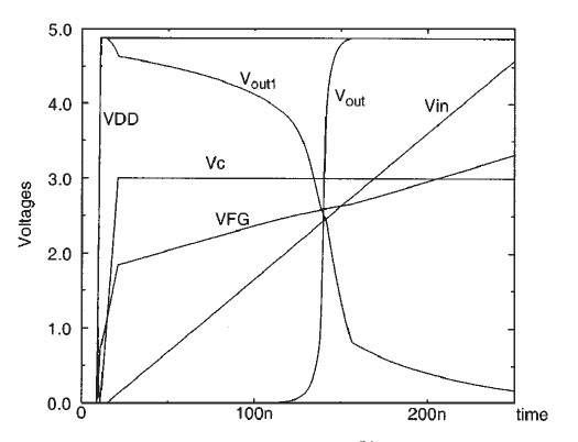

Hi All,
I came across this particular waveform of the Transient analysis see attached image..
DO you all think is it possible to get such waveforms using trans analysis.
What could be the Vin .Is it a square vpulse or traingular vpulse?
Thanks in advance
Muffassir
Yes it should be easy to do. Vin could be a triangle or pulse. I usually just use a pulse with slow rise time to get a triangle or sawtooth.

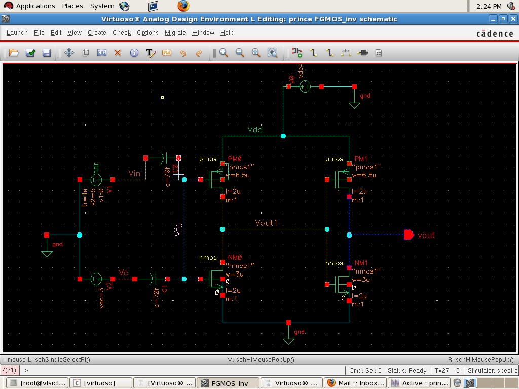

I want to do the simulation of this circuit from IEEE paper.I have redrawn it in cadence.

I simulated the circuit using Vdd as vpulse(V1=0,V2=3.3, Period=120us, Delay=200ns, tr=tf=1u, Pulsewidth=75us)
Vin as triangular wave ( V1=0,V2=3.3, Period=100us, Delay=200ns, tr=tf=50us, Pulsewidth=0)
Vc as Pulse( V1=0,V2=2V, Period=100us, Delay=500ns, tr=tf=2u, Pulsewidth=50us)
for setting the power supplies.
W/L of both inverters are PMOS=6.5u/2u and NMOS=3u/2u.

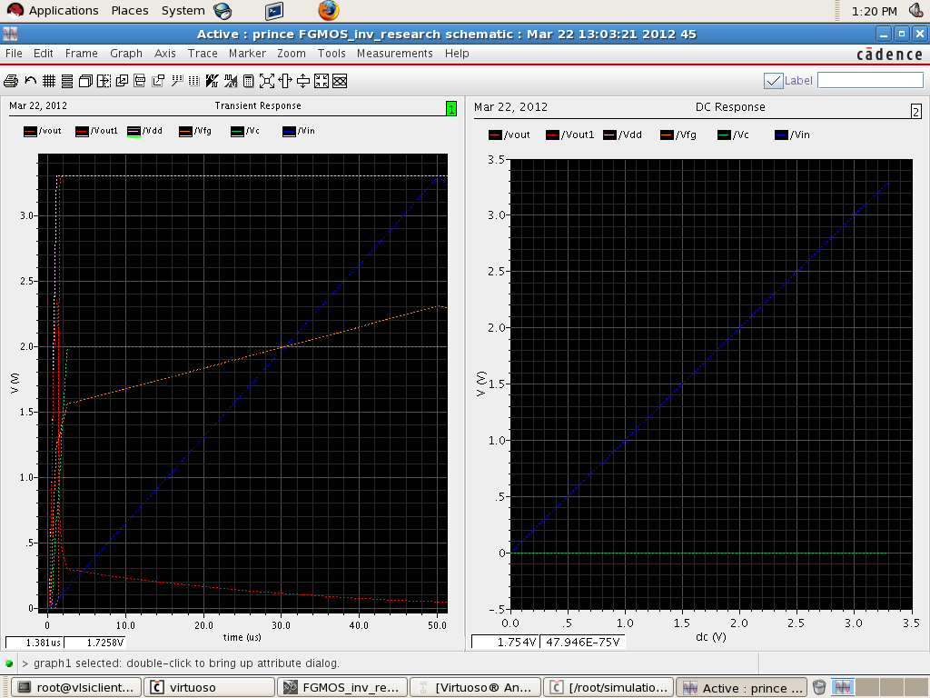

The outputs i am getting after the simulation are shown in the image outinverter.png and expected outputs from IEEE paper are shown in the outexpected.png.
The outputs for Vout1 and vout are not according to the exxpected. Also i am not able to get the DC transfer characteristics of the above circuit.I have even also set readns=spectre.fc file from trans analysis.
On the basis of the statement by the author is there any thing i can set the options in trans/dc options so that i can get the output of DC characteristics/trans analysis.
Any help is much appreciated.
Thanks
I suspect the differences are due to the process and voltages, but I cannot be sure. You are only using 3V rather than 5V - I guess it is a smaller geometry process than the original paper. However, your transistor lengths are quite high for a small geometry. I think the problem may be a design one rather than due to simulation. Also, reduce the transient analysis maximum step size. It isn't a problem at the moment but the defaults are usually too high.

Thanks a lot for the help .I got the expected waveforms.The only thing i did is ...
In the capacitors properties there is an field for Initial condition i set it to '0' .
That did the job !!!
