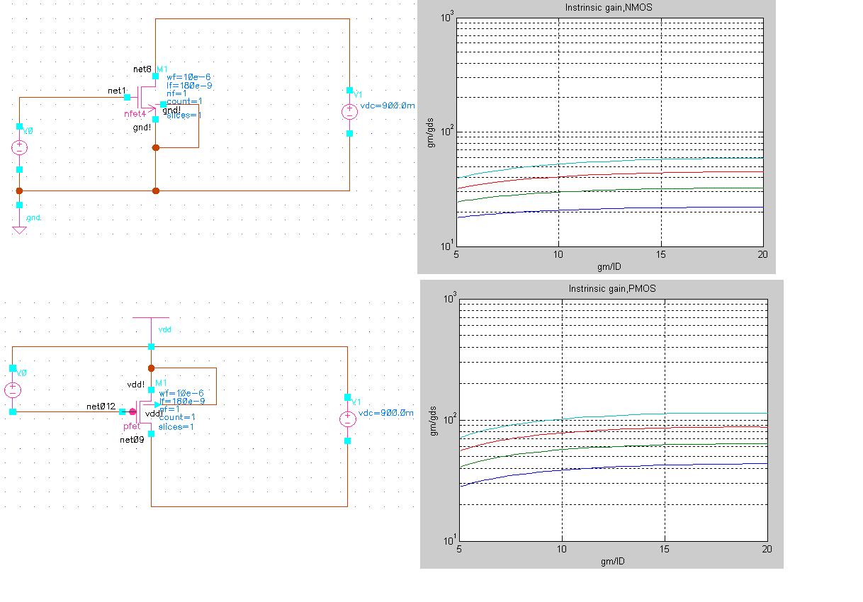

Hello all,
I am trying to generate intrinsic gain vs gm-id plots for 0.18um nmos and pmos devices. However, I am noticing that intrinsic gain for pmos is greater than that for nmos. I guess it should be the other way around. I would be grateful if someone could point out the error in my simulations.
Setup for nmos device
VGS = 0 to 1.8V, VDS = 0.9V
Setup for pmos device
VSG = 0 to 1.8V, VSD = 0.9V
