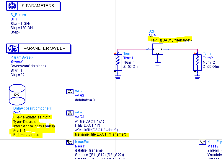

What are you trying to do, and why do you want to "import" the data?

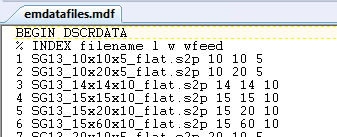

If you want to look at (or optimize with) a large amount of data files, you can use a swept variable as an index into a namelist.mdf file that holds all the filenames. Use a DAC element to read the filename(s) from that namelist.mdf file into a variable, and use that variable as the filename in your S2PMDIF element.
If your filenames have a simple structure, you can also use the sprintf function in variable defintions, to dynamically build filenames from a swept variable.

Ok, I really think you should create a schematic to automatically process all your files. Importing them manually will results in many *.ds files, so you end up with many single files again. By reading them into a schematic, you can create larger resulting datasets that combine multiple files, and access that through an index.
In the ADS examples, there is an example workspace DataAccess_wrk which show various methods of using the data access component. That's what got me started with this type of work. In my case, it was optimization of a parameterized equivalent circuit model to fit hundreds of S2P files (each s2p file for a different parameter combination).
Below is what I had used. Be careful with defining the DAC parameters, it is easy to make mistakes there.

Hi. I've got it working and have attached my schematic and data files. The schematic is based of IVCAD's ADS template for pulsed S_params measurements.
I needed to format the original data files from the IVCAD measurements to match the sample layout, then create a file with a list of files to be read in, as Volker suggested. I needed to read in two different files, so have used 2 DAC's to access the filelists and one to access the data.
DAC1 gets the filename from DAC2, where DAC1's iVar (INDEX) sweeps the pulsed bias points, while DAC2's iVar (FILE_INDEX) sweeps the files. DAC3 is similar, where its iVar is the FILE_INDEX and its filename is passed to the 2-port simulator.
Needed 2-parameter sweeps. One to iterate the files (outer loop), and the second for iterating through the s-params (inner loop).
Hope this helps.

My proposal is to sweep an index variable instead (1-D sweep), where the two bias variable values are read from the the *.mdf file together with the corresponding s2p file. One line in the *.mdf per bias condition. In my example above, it was 3 parameters plus the s2p name.
Implemented this way, you have only valid data points and all the ADS data management is straighforward.
