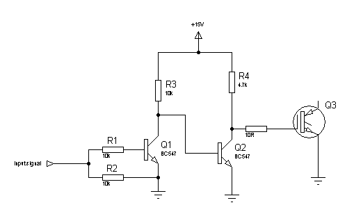

As an alternative, one could do the same thing with two NPN transistors as shown below. (It uses one less resistor too, for the penny-pinchers).
btw, Is the gate stopper resistor really needed? I know they're important to prevent oscillation when MOSFETs are used as linear amplifying devices, but I wouldn't have thought oscillation could be a problem in a simple switching application. Am I missing something?
It is used here as "safety" to make sure the IGBT doesn't turn on accidentally. It happens usually with high voltage but can sometimes happen at low voltage as well. If you search on Edaboard, you'll find lots of threads complaining of problems such as damaged MOSFETs/IGBTs, where the solution was that one resistor.
What do you mean by gate stopper resistor ?
The resistor connected to the gate of the IGBT (R5 in this picture).
Surely that is the purpose of R2? I was wondering about R5.
