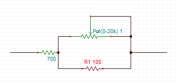

I think this will work. Pls follow the link
https://obrazki.elektroda.pl/1964705400_1353850533.png
Thanks for this, but I've actually tried this method. I found it works in theory but isn't linear enough. It goes from no change to a sudden maximum change. I can't remember which direction though.
