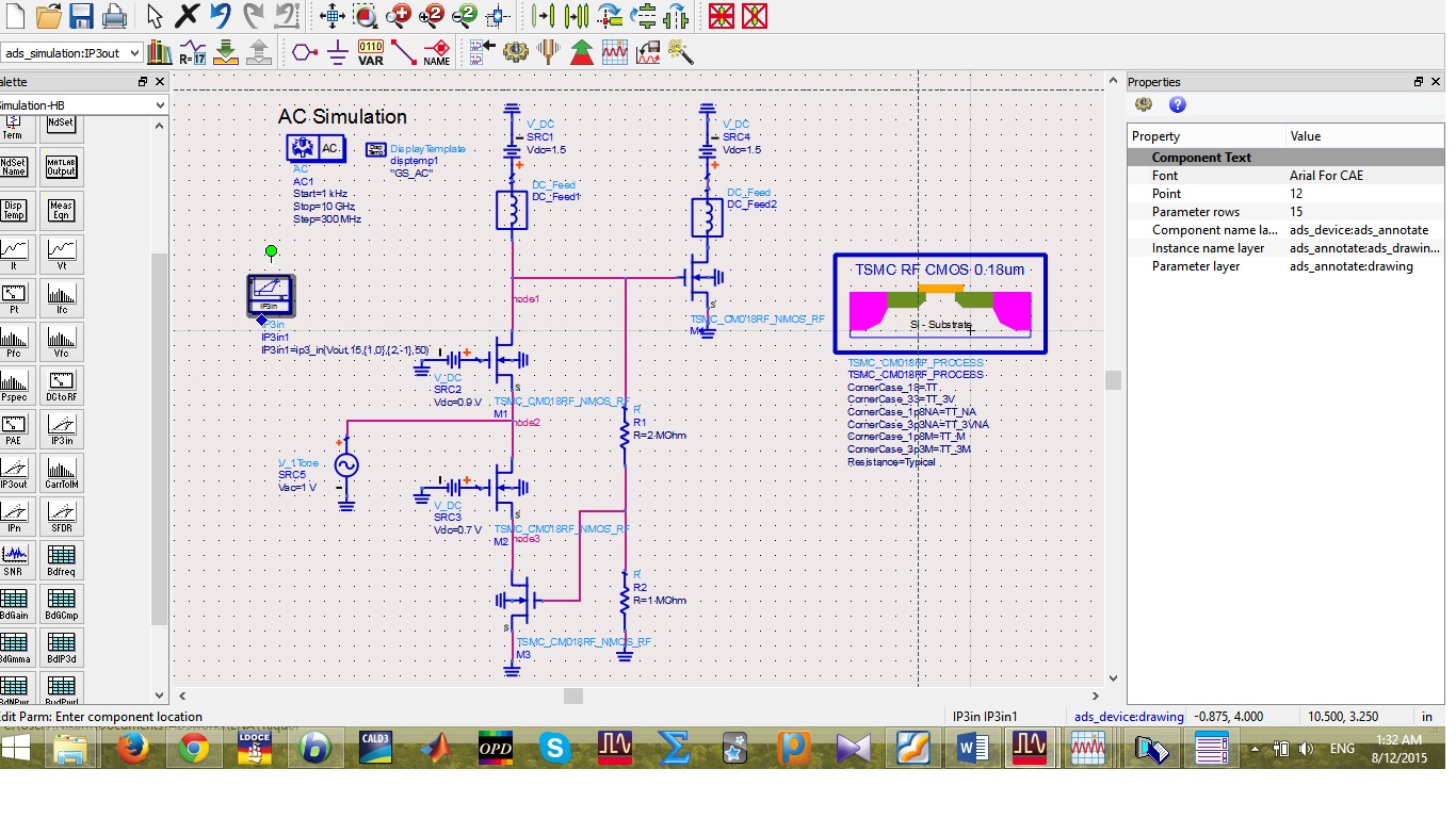

Hello
I am working on this circuit as a homework.
I don't know how to see the IIP3 curve in ADS.
I have 2 question while working with "IIp3 symbol":
1:How should I define "harmonic frequency indices for the fundamental frequency" for my circuit?
2:How should I define "harmonic frequency indices for the inter-modulation frequency" for my circuit?
An example in ADS help is : y = ip3_in(vOut, 22, {1, 0}, {2, -1}, 50)
