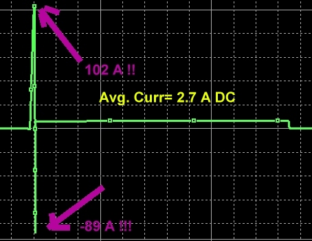

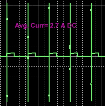

dear all
how can i limit the mosfet current spikes & does it important to takecare of the currents spikes or its avg ??
Some of this spiking may be due to using unrealistic simulated,
or overly stiff real gate drive. You have a lot of Qgg that has
to go somewhere. Either out the source, or out the load,
depending on the transition.
You should check datasheets for any pulse or transient
current limits in addition to DC ratings. RMS currents ought
to be no more than the DC, and my rule of thumb is peak
no more than 10X DC (unless you have reliability data).
Look at what happens with (say) a 10-ohm series gate
resistor added. Look at what a drain snubber or simply
representing true parasitics (R,L,C) in the load and the
power device do.

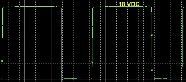

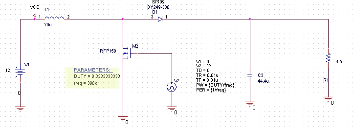

Unfortunately, you don't even tell which quantity is displayed in the waveform. How should we comment it?
A high current peak on turning on the FET (Id or Is) can be however expected, because BY249 is a slow rectifier with large reverse recovery time. It can never work at 300 kHz in a real circuit. As mentioned, you also shouldn't drive the MOSFET gate with an ideal voltage source. (Fortunately, no real gate driver is an ideal source...)

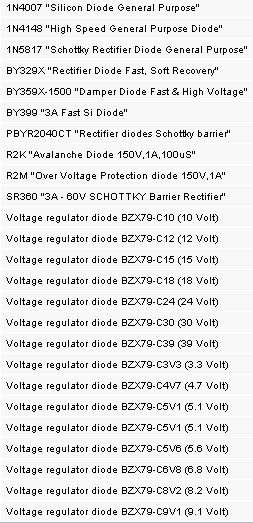

i do not have alot of diode to choose (plus do not have alot of spice model alsoo) kindly check th following

I'd think the 1N5817 is a bit sparse for this application, both w.r.t. voltage (Vr(max)=20V) and to current (Imax=1A).
Better use your BY329X, BY399, or SR360 diode.
