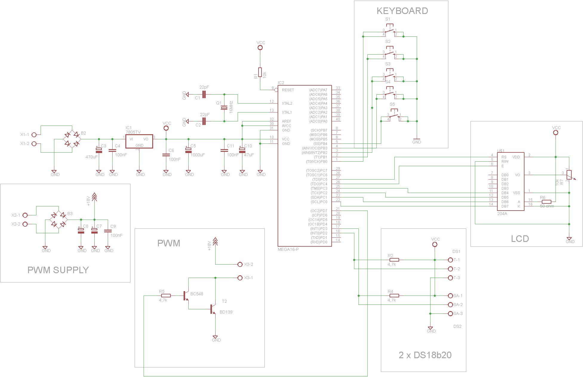

The circuit is powered from toroid transformer 30W. Transformer with two voltages was created: after rectifying 8V DC for uC stabilizer and 16V DC for fans.
Schematic:

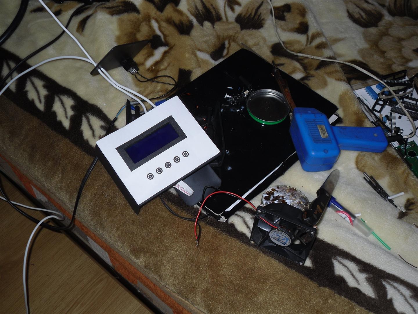

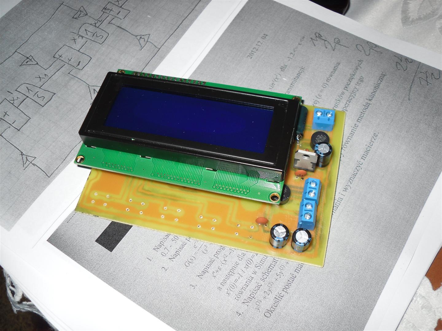

Pictures of construction:
