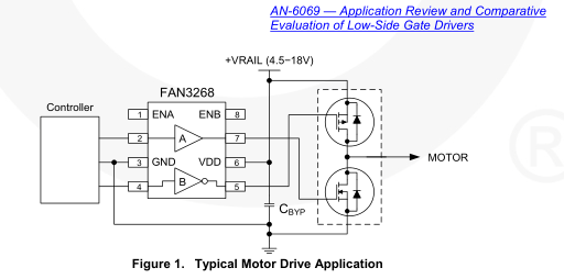

Bootstrap voltage works the same as a charge pump supply and requires PWM switch output to charge and dump the voltage with the diode clamp. If you dont use PWM, dont use this chip.
In any case I suggest this is a better driver with logic level inputs and internal clock no external bootstrap required.
upload_2015-7-29_23-33-47-png.93477
Sunny, the motors I intend to drive eventually will have up to 100 V.
