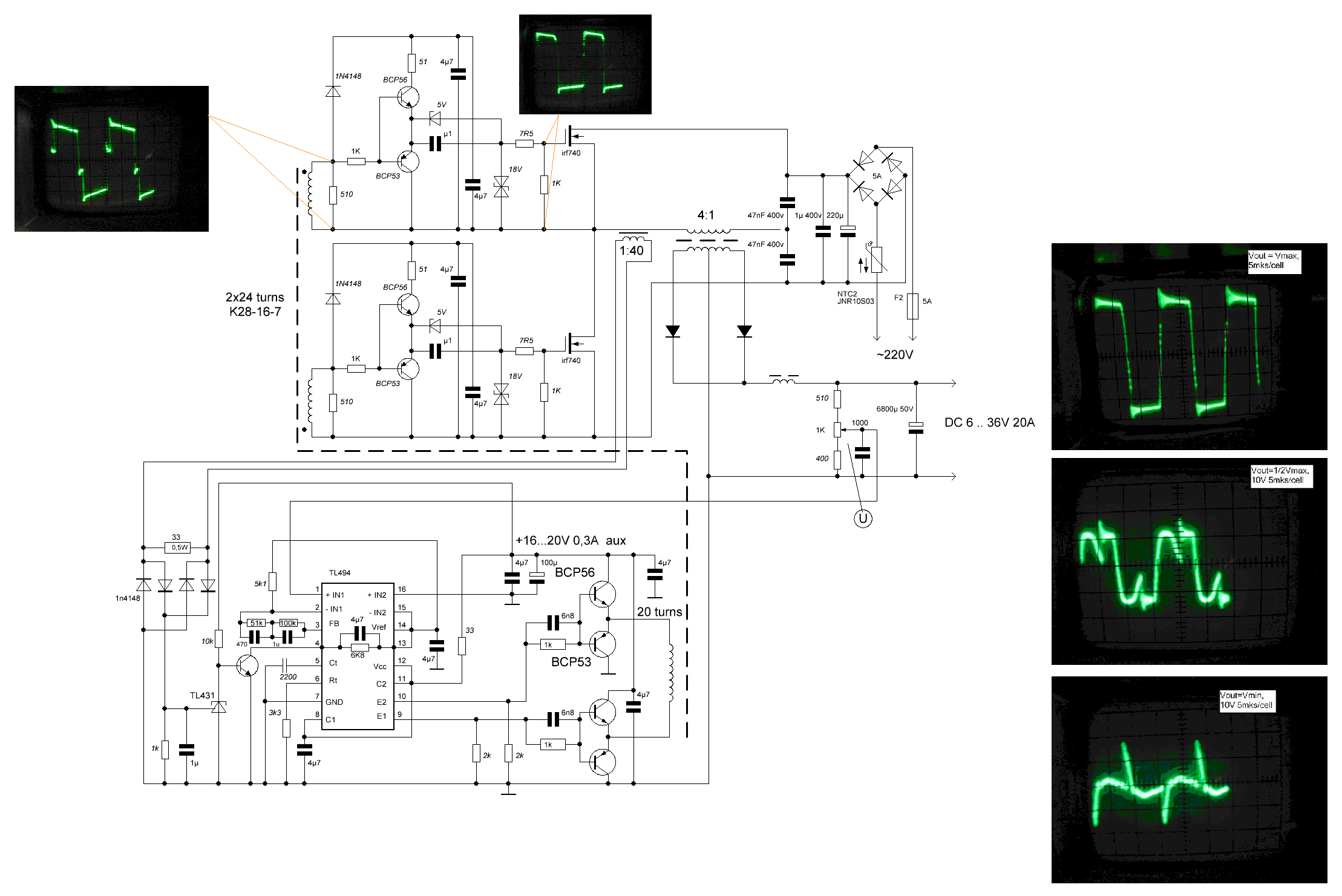

Something have done myself.
Works quite well, but was got excessive in a complicated way.

Some comments on your presented circuit :
1- why half bridge ? because it needs more components . 2- and why those externally components ? ( transformer driving and those BJTs ?) . 3- why not a simple float driver instead of those components ?

Hello there DeepOne,
When you refer that "was got excessive in a complicated way", what you mean by that?

Hi Deepone,
It seems to me like you need several transformers. I was under the impression that one would suffice

DeepOne,
You are driving the MOSFET through transformer? Why you haven't used the turn ratio equal?
I can't understand the part of the 2 capactior of 47nF (at input). Can you explain that?
I think he/she have used that capacitor to neutralize the effect of wires ! it is a usual solution to use a capacitor nearby collector or drain for totem pole circuits or main switches to prevent some resonant effects ( unwanted resonant )

It is not to set the ground rail? If he didn't used that, how would be the schematic?

Hi Goldsmith.
- why half bridge ? it needs more components.
basically by reason of easier make powerful transformer
transformer driving for galvanic uncoupling, BJT and not a simple float driver for reliability. And else this is interesting for me - look as all this will work in realities.
Hello AMSA84
I mean surplus amount of transformers and inductors ).
To provide spare for making the negative offset on gates. Possible do on other way, but i want to try this way.
this is half-bridge capacitors, it must be calculated on sufficient power.

I still not understand why those capacitor are there. And in that way, how you use the 1:40 and 4:1 transformers on that part. Maybe is the way that the schematic is drawn.
Re: 1/2 kW SMPS 2-50V 0-10A
1:40 current sensor, ring in which pass through wire from main transformer as primary windings.
4:1 transformer is main transformer, amount of turns in which depends on used ferrite core, for example 40 primary and 10 secondary turns.
Strictly speaking it's 4:1+1, I think.
Yes, sure.

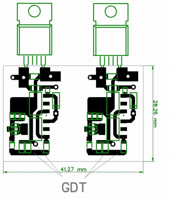

Possible try to refuse from gdt, but i not certain about that will work with such feedback on voltage.
Hi Deepone !
Agreed !
I'm disagree about this ! float drivers are guaranteed for high voltages ! ( there are easily available ) . however if you need pretty safe process ( for example in a high voltage system ) , an opt coupler would be ok ! but still i'm in this believe that a float driver is good because of linear and predictable behavior ! hardly i use a transformer as driver in my SMPS designs . ( in transmitters it is a safe and good way but here it is unnecessary ! ) . it is my opinion but of course you can be disagree with me .
In addition : a transformer can change matching between your main PWM ( it's dead time ) , and reflected PWM . and it is possible that you see some oscillations in it's out put .
Another thing : you have used four transistors in primary . you could use just two transistors and a capacitor ! ( in series ) and for the secondary just an RCD network !
