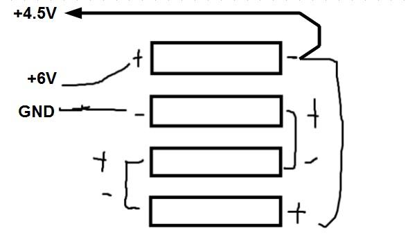

That was my original thread asking for help getting 2 different voltage 4.5v and 6v from a battery case.
After takening into account of some of the ideas posted I got a new case for 4xaas.
the diagram wiring looks like this
anyone know anyway I can get 2 voltage simulataniously from this battery pack?
Where do i solder the wires ty?
Connect this way......................
Regards KAK

ty kak111 it works.
Not really worried about constant power.
As long as it works.
