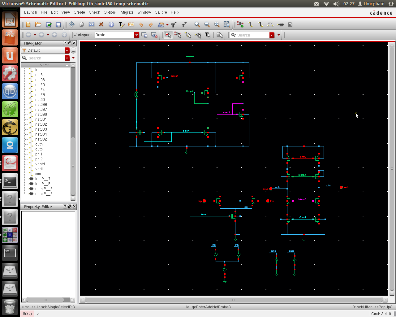

Hi all
Any one has experience to bias fully differential folded cascode op amp without cmfb? It took me a lot of time to make each transistor in saturation. I know with cmfb you can make it more saturation easier. Please let me know your suggestion. Thanks a lot
CMFB is the only solution I feel. If you want to avoid use of a differential amplifier for CMFB network then you can use resistor based CMFB (Follow text book by B.Razavi). But finally it will be CMFB.
As your ckt is a cascode, it inherently has a shielding effect but still across process, voltage and temp it would be hard to keep all the MOSFETs in saturation. So better you go for CMFB.
I do have a suggestion outside CMFB for the ckt that you have designed. The biasing ckt will work but is not perfect. Since you are biasing a cascode MOS by a non-cascode MOS in the bias arm the bias voltage generated might not be proper (Vth will be different). You could have used similar casode structure in the bias arm as well (Follow text book by B.Razavi). Two PMOS in the green bias arm and two NMOS in the pink bias arm.

Thanks for your answer. I have fixed my bias circuit as your suggestion. The new circuit without cmfb working well. I want to build a discrete cmfb but the question is how to run dc gain and phase margin. I know people can run it in cadence spectre and Hspice. If you know how to run it please show me how in detail. Thanks a lot

In the schematic biasing ckt you are still using PMb0 and NMb2 to generate baisp2 and baisn2 .... so it is same as the previous design .... The 2nd and 4th branch from left is sufficient for biasing (with little modifications of course) ....
You can use low voltage cascode biasing technique (that was what I was mentioning) ... you can refer to cascode current mirror biasing in the Current mirror chapter (Pg 139) from Design of Analog CMOS Integrated Ckts by B.Razavi.

I do not think you can do it without cmfb. Even though with extremely careful biasing you can make all transistors into saturation region, it is not reliable. DC voltages of your two outputs are not predictable. With little variation (temperature, process, etc.), your circuit is not going to work. Could you let us know why you need a differential amplifier without cmfb?
