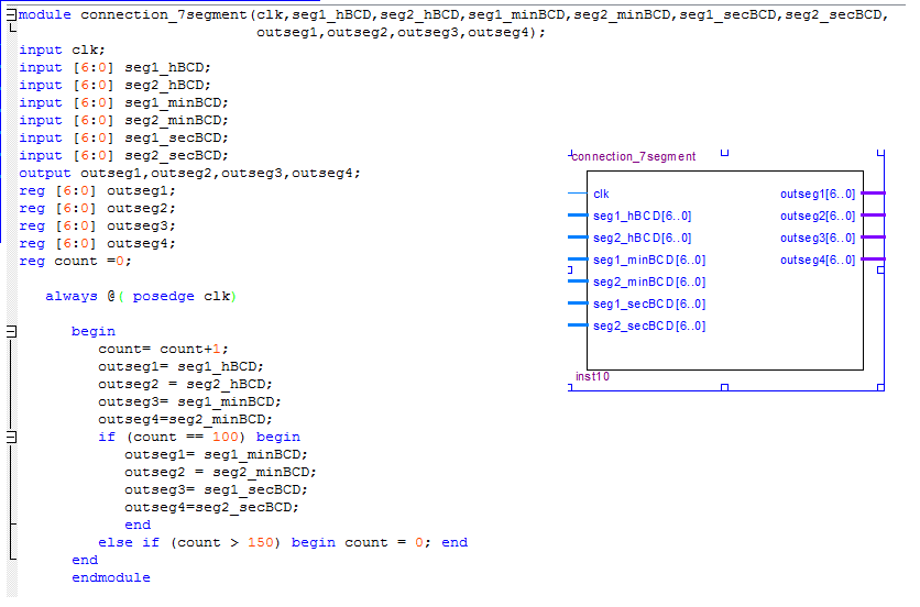

that looks interesting. i've wrote this code shown in the image
basiclly what i've done is, i took all the signals from the BCDs s inputs and i used if statements to decide which signals to display and assigned them to the output, the output would be hh:mm, then if the counter is 100 i changed the outputs so it would be mm:ss and when the counter is greater 150 it will reset to 0. so the secounds should appear for 50 clk cycles. i suppose i need to work on the timing more but is this legal? does it make sense?!
Actually you want to check for count >= 100 && count <= 150, otherwise you'll only update the min/sec display for a single clock cycle which will freeze the output until the next time it gets captured (if you want to display seconds counting then you don't want to freeze the count. What you've done in your code is make a multiplexer with a select that is derived from a count value.
Also you should use non-blocking assignments (<=) in edge sensitive always blocks. Using blocking assignments (=) can lead to simulation/synthesis mismatches. You should only use the blocking assignments in combinational always blocks i.e. always @*.
