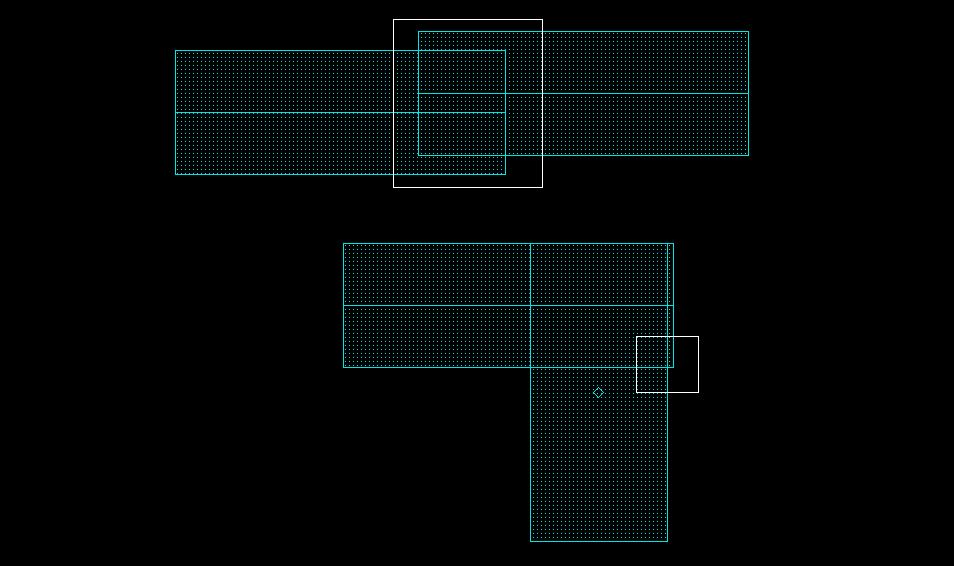

Can anyone please explain me about the effect of notches in layout ? Or kindly provide me any docs or any link.
I've attached the layout view for example.. Here the Metal 1 layer is having notch and DRC will not detect this as an error..

Actually this isn't a notch. A notch is a hack, nick, recess, chamfer, groove, indent, jag or kerf, i.e. a small missing part in a structure.
From a DRC document:
"Notches are to be considered as spacing and must respect the same minimum values."

In the snap what i've attached has the metal not connected properly ( metal is not stopped in the place where it should be ) , Will it cause any problem?
No.

Mask/photoresist (lithography) resolution isn't good enough to reproduce such tiny structures. DRC would tell you a violation.

Notches may fail to print as drawn. This is one of those
violations that's more of a "you're not going to get what
you drew" warning than a "you're going to blow up" error.
Since the verification tool knows nothing of intent, you
get warned regardless.

From the Above statement (from erikl), I 've understood that,
The metals in the following snaps have no notches and there's no problem with those connections, (If i'm not right, please make me clear)..
https://obrazki.elektroda.pl/9851328800_1392014942.png
Yes, you're right.
And the metals in the below attachment have notches, But DRC will tell this as a violation..
https://obrazki.elektroda.pl/2885710500_1392014978.png
Again, this isn't a notch, because these are 2 different metal layers. Only notches within one layer are flagged.
