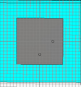

dual feeding in a single patch

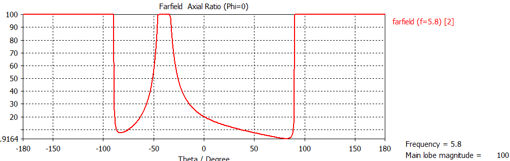

okk...i am enclosing my results here for axial ratio.
farfield axial ratio for 1st radiated field
farfield axial ratio for 2nd radiated field
now tell me how these are circularly polarized??

Sonia,
Why are there two different results?
Are you exciting the two ports separately?
Onthe other hand, the scale of the vertical axis is not clear for me. Can you clarify?
And please show the plot of directivity.

yes there is two ports ..and m exciting these separately...what to do please tell me
vertical scale is showing axial ratio..
and here are the plots of directivity.
In order to obtain circular polarization you must excite the two ports at the same time with 90 degrees phase difference!
Of course... but it's id dB? in times?
It looks quite normal. There is only one, I see it is from port 1.
Axial ratio from port 2 looks strange.
You should study some basics about antennas.
When asking for help, you should give clear information. For example, it remains unclear how is the design.
