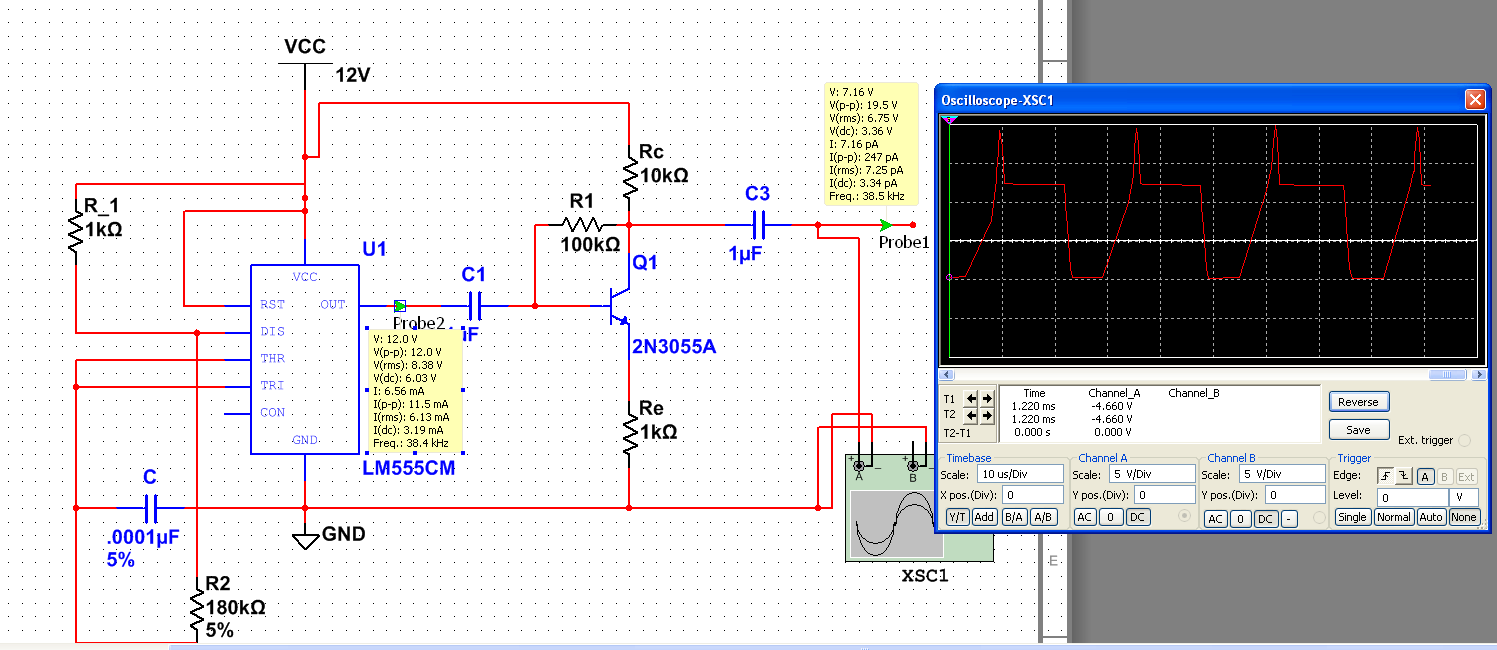

Hi There,
I have 4x MA40S4R/S Ultrasonic Transducers, and a 12V Lead-Acid Battery. I need something to drive the ultrasonic transducers to about 40Khz at 20 Vpp TX. I have come up with using an astable 555-timer to create the 40Khz square-wave and I have tested it on the breadboard and on multisim and it works fine when I use one of the four transducers I have. The problem is I need to amplify the output so its output voltage is around 20Vpp so that way it works better. I have been messing with it in multisim but wondered if this was the best way to do it, or if you could help me by providing me recommendations to my circuit or if there is an even simpler approach to driving 4x transducers at 20Vpp 40Khz.
Datasheets:
https://www.mouser.com/catalog/specsheets/Murata MA40 Series.pdf
https://www.ti.com/lit/ds/symlink/lm555.pdf
see attached pic of my multisim circuit, any help is greatly appreciated.
https://obrazki.elektroda.pl/2469135200_1434976220.png (also why does my output looks so funny, it should be more of a square-wave).

Some options to increase the transducer voltage:
- use a H-bridge configuration
- use an output transistor with inductor load
The biggest problem driving these transducers is that the resonant frequency of the transducer is a very sharp peak.
The driving frequency must coincide exactly with the resonant peak, or very little energy will be transmitted.
Its not just a case of feeding more power into it, but feeding in the exact frequency which is fine when you are tweaking it on the bench, but building something that will stay exactly in tune for any reasonable amount of time can be very difficult.
Best approach is to use the transducer itself as part of a feedback oscillator so it automatically oscillates at the energy peak.
There are actually two peaks very close together, one is a voltage peak, the other a current peak.
The current peak might be better when trying to do this from a low supply voltage.
You might like to look at some of the modular bridged audio power amplifier chips for doing this.
If you use current feedback from the transducer, you should be able to get it oscillating AND absorbing significant power at a fairly low drive voltage.
Murata 40 kHz air ultra sonic transducers (also similar products from other manufacturers) have moderate bandwidth of about 1 kHz, so meeting the resonance frequency is not so critical. Most processor based distance measurement systems are operating it just at the nominal frequency.
For a simple drive circuit, you can refer to figure 14 in the application manual. I couldn't find it presently at murata.com, so I uploaded a backup copy.

A 555 has plenty of output current to drive a ultrasonic transducer [b[without[/b]15A power transistor. Use two 555 ICs, one as an oscillator and the other as an inverter. This circuit can produce about 20Vp-p:

The Murata device has 2550 pF capacitance which at 40KHz has a reactive impedance of 50 Ohms and 20Vpp max driver rating. THe resistance or real energy depends on the motional vibration levels but is likely to be in the same range at maximum voltage of 20Vpp for low Q pulse sonar.
This is easily achieved using 10V full bridge to get 20V differential. Matching the driver impedance may be important for transient response when turning off if this is intended for SONAR testing.
THe figure illustrated in MUrata's datasheet offered by FVM shows a pair of 4049B CMOS drivers AC coupled in differential mode using Vcc=12V The impedance of 4049B's as I recall is around 200 Ohms at 15V thus in a 2S2P matrix ( 2 Series+2Parallel) the net impedance is still 200 Ohms. Thus significant drop is expected from each driver. THis impedance lowers at rising Vcc and varies considerable among vendors or 4069B.
I would consider a dual half bridge at 10V with RdsON < 1 Ohm
I would use the fastest CMOS inverter to produce the complementary input and send the burst to the device and then momentarily for turn on both drivers low or High to shunt the device before floating them to reduce the resonant dwell time after end of burst to get a crisper burst (20us) after Tx before Rx is processed. This could be adjusted to produce the best transient response.
THese are recommended for Vcc=11 so if you used 12V add an RC current shunt to drop 1V at expected current, which may be in the range of 20V/50Ohms= 400mA Peak, so 2 or 3 series 1R can be tried so as not to exceed the 20Vpp max rating for current and power dissipation reasons in the device.

2550pf is 2.55nF. I calculate the impedance at 40kHz as 1558 ohms, not 50 ohms. Two 555 ICs as a bridge can easily drive it.
Murata's applications sheet shows two CD4049 inverters in parallel as half a bridge. Then its minimum output high current is 15mA and has a 2V drop with a load that is 667 ohms. The 555 has a typical output current of 200mA.
My pocket calculator also tells Xc = 1560 ohm.
But more important, the input impedance at the resonance frequency isn't given by the sensor capacitance. It's a real value at the parallel and series resonance. A transmitter would be operated at the series resonance which has typically a few 100 ohms real impedance.
Then why does Murata recommend driving it with a weak little ordinary CD4049 Cmos inverter/buffer IC? They show two inverters paralleled for each half-bridge and a 12V supply. The supply current is only 15mA and the output is 17Vp-p on one schematic and is 20Vp-p on another schematic. Then the piezo transducer load is 1133 or 1333 ohms.
