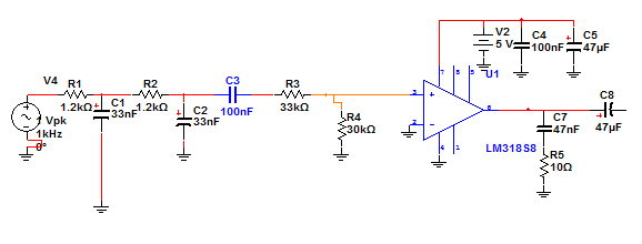

Hello everyone,
I am confused to make Audio output amplifier for mono. I used LM386 amplifier.
The input of data comes from processor analog pin.
I show the image.
however, I do not really understand whether I need RC filter in the output amplifier.
Is there anyone have experience on this, please help me ?
How to make a correct and good audio output amplifier in detail?
Thanks for your help.

The RC network on the amps output is called a Zobell network. As the audio frequencies rise beyond the audible, the impedance of a loudspeaker coil also rises. The impedance of the zobell network falls with frequency so the amplifier has a reasonable load on it through out its range where its gain exceeds unity. Leaving it out can give rise to ultrasonic oscillations.

However, I am still confused about the resistor 10 ohm placed on the output LM386.
What is the function of the resistor anyway ?
Thank you very much
Re: Audio Output amplifier design
At very high frequencies the ten ohms as the load for the amplifier because the impedance of the loudspeaker has risen to perhaps 100 ohsm.

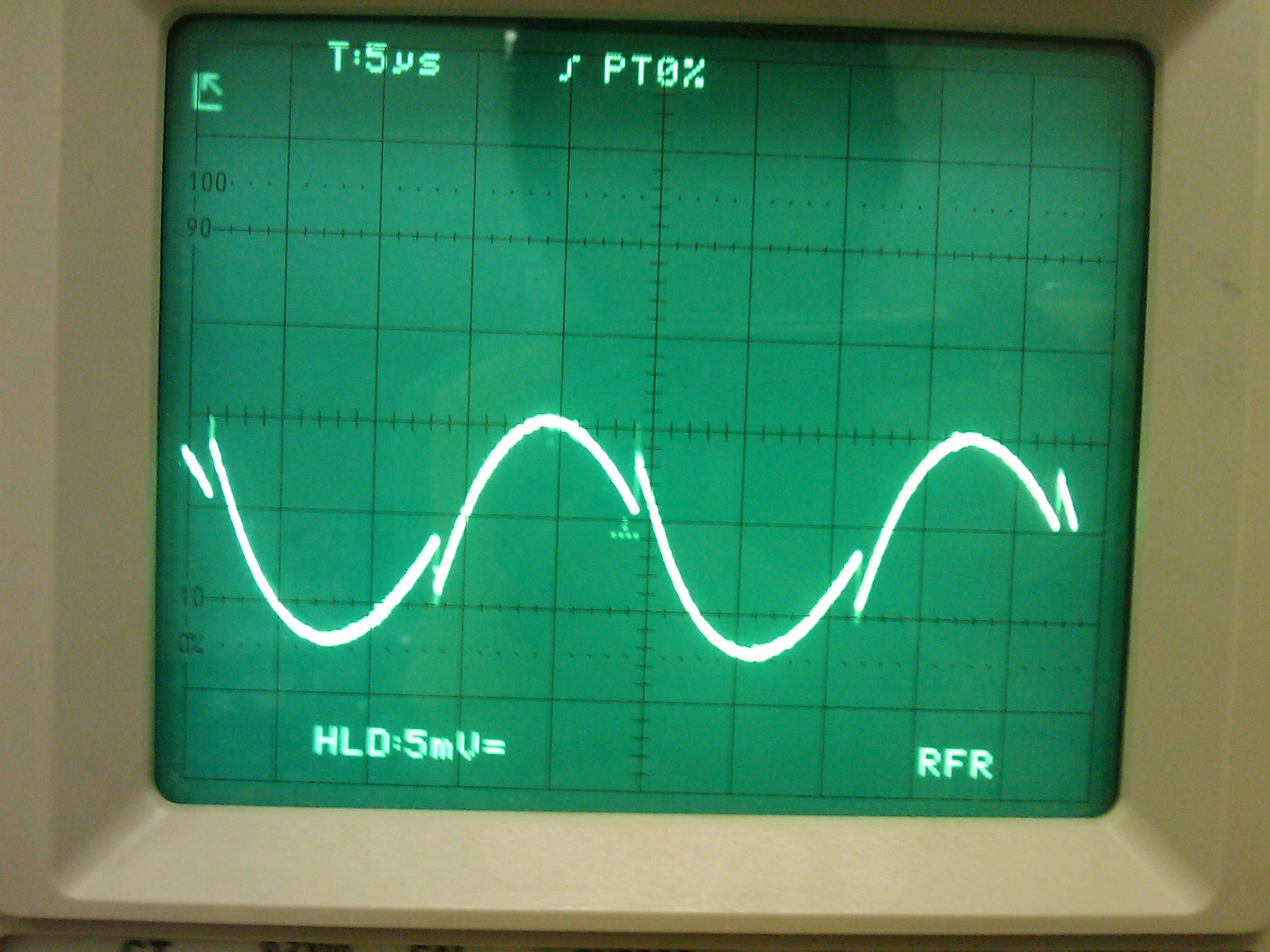

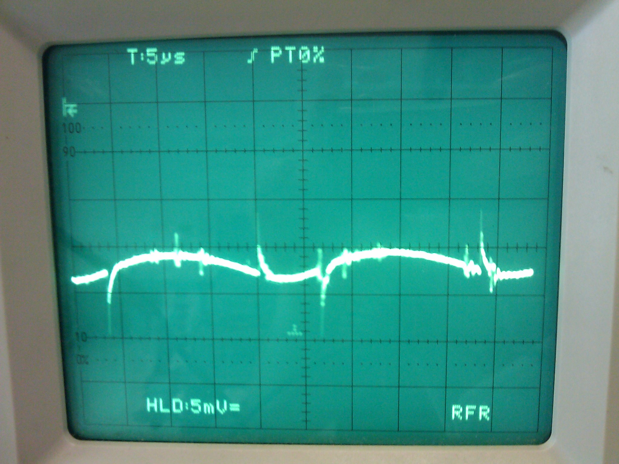

I have tried the circuit by giving square wave in the input.
However, I am also confused about the RC circuit before the LM318A Amplifier (actually LM386).
Is it a bandpass filter ? or Is it used to generate analog waveform ?
I have tried it using oscilloscope. the probe is connected in positive input of LM386
When I change the dutycycle of square wave, the waveform is shown in dutycycle_ubah.jpg
Could you please explain, how they works ?
Thank you very much.
Best regards,

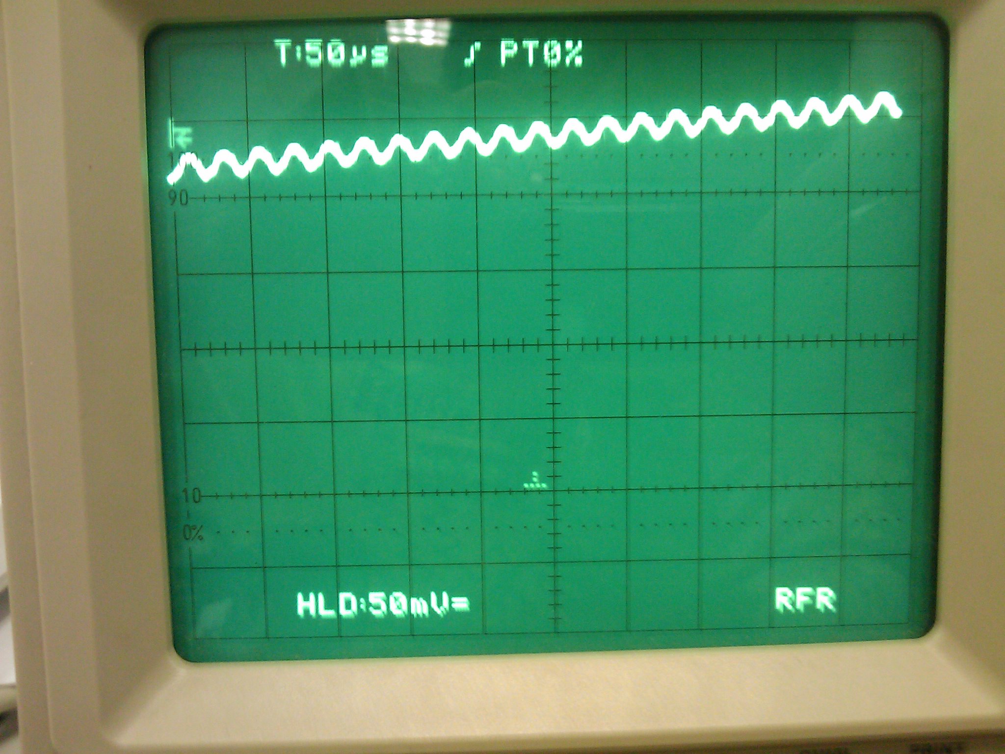

What do you expect at the filter output when changing the duty cycle? Particularly with a square wave frequency far above the filter cut-off frequency. I won't expect much, apart from a magnitude change. It's hard to detect anything from your waveforms, because time base and attenuation both have been modified.
Hi
thanks.
I have attached the waveforms, when the attenuation and time base is the same with the same duty cycle.
I change the duty cycle from 0x00 to 0xFF and goes to 0x00 -0xFF again.
The duty cycle is based on the audio data from wave format.
The frequency of square wave is 44100Hz.
changing the duty cycle based on the data format is used to generate sound of music.

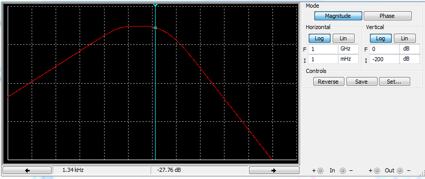

based on my software simulation, the cut off frequency is only about 1.5kHz
Yes, somethink like this. As you see, it's not a reasonable filter for a general audio amplifier. But where did you get the filter circuit? Why don't you simply refer to a LM386 datasheet example circuit?

Bodeplot from software, cut off frequency is about 1kHz
could anyone please explain how this circuit works?

Your previously have written about a processor analog output which turns out to be a PWM signal. That clarifies the purpose of the high frequent square wave and the low pass filter. If you intend an audio frequency range as it can be represented by a 44 kHz sample frequency, you would need a steeper lowpass than two cascaded first order RC filters.
Alternatively, you can feed the pwm signal to a push-pull switch and place a LC filter before the speaker to suppress the 44 kHz (class-D operation).
