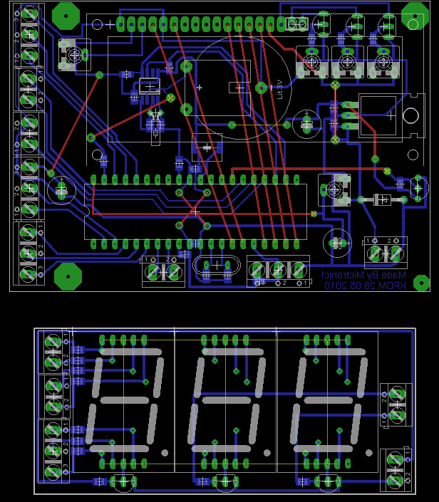

Printed board and hardware
The quality of projected program is poor. Also, the board do not match the display (so-called “sandwich”), what makes it not very aesthetic.
An impulse equivalent of a popular stabilizer of small dimensions and good parameters was used to stabilize the voltage of 5V.
