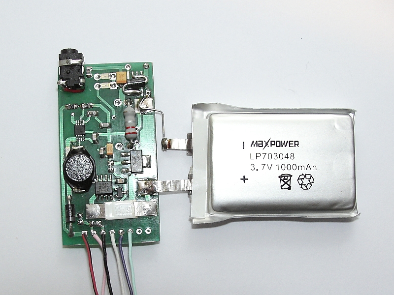

Scheme of the power supply system 5V/1A is shown below:
Pictures showing assembled power system:
More details, schemes of other three variants, PCB drawings and assembly schematic can be found at: LINK.
