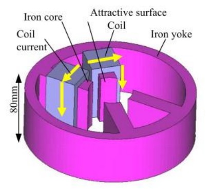

How to calculate Eddy current force generated in a rotating ferromagnetic material in D.C. magnetic field which exerting a pulling force on rotor about 2000 N.

I have a doubt that, whether eddy currents exists in a rotor which is rotating in a DC magnetic field or not?
Can we create a strong pulling force on a rotor in a particular direction by using AC magnetic field??
i am attaching a figure, please check it. https://obrazki.elektroda.pl/5242770900_1369923873.jpg
in that,
i want to create a magnetic pulling force on a rotor which is rotating at high speeds. what type of supply i have to use?? AC or DC?
The eddy currents in a rotating cylinder or disc will primarly act against the rotation speed and decelerate it, see don't see an obvious option to generate a pulling force.
Yeah! if it is AC excitation obviously there will be eddy currents irrespective of it motion or speed!!
How about, when its rotating in constant DC excited magnetic field?? Eddy currents are generated in this case?
