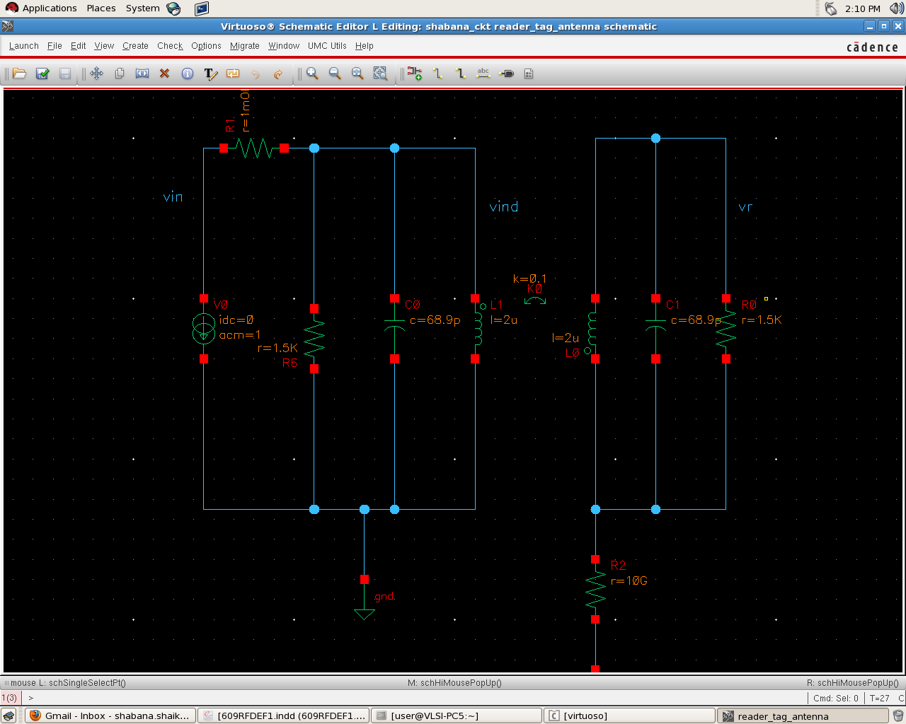

Hi All,
Attached is the schematic of the circuit and plot of voltage at Inductor Vs Frequency.
I want to plot the Vol across inductor (L1) Vs Freq.
This is the process I have followed:
1. Go to analyses -> Select ac
2. Set the start and stop freq sweep as 0 to 50MHz.
3. Go to Output -> Select calculate. It will take to another window -> Select Vf for ac -> select the net of the inductor L1.
4. Click on Get Expression of the Output. Add the exp to the output window.
5. Click the "Netlist and then Plot" icon.
I expected the output as the resonant circuit output, which has its maximum at 13.56MHz.
But unfortunately, the resultant plot is shown in as attachement.
Can you please the reason for this abnormal behavior?
Correct me if I am wrong at any of the steps.

Well,i have to remarks :
1.)In the plot you provided at your first post the y-axis is in dBm.
dBm unit is used for power measurements and not for voltage measurements.Nevertheless,you can easily convert it in Volts (rms or peak) if you are given a characteristic resistanse :
P=(Vrms)²/R
and P(dBm)=10*log(P/1mW) , where P is expressed in mW.
Combine those two equations and you can deduce the Vrms.
2.)Substitute the ac current source with a vsin source from analog lib with (acm=1) and then run ac analysis.Go back to the calculator as you did and plot the VF you are interested in.

I have run the simulation as you suggested and attached is the plot.
The attached plot shows unity from 1MHz to 20MHz.
If you consider the first part of the circuit, it is a resonant circuit.
If the expectation is to see the resonant frequency of the circuit, what should I plot?
Your voltage source has a really small resistance (R1 =1mOhm ?), so that vind=vin.
I tried to draw plot between current and frequency. I selected If in the calculate menu. When I tried to select the net from the schematic, I am getting this error.
*Warning* object selected is not a valid selection object
I have given Vsin as input. 1KHz is the frequency and ac magnitude is 2V.
Pls correct me where I am wrong. I am newbie to Cadence Spectre.
-Thanks!
If i remember well you must hit on a node of a source or other device to plot current and not a net.Give it a try.

This sounds as you are going to command a TRAN analysis (because of 1 kHz).
For ac analysis you specify just an ac magnitude - that`s all!
And watch your frequency resolution. Your results as presented earlier look rather strange (because of the "edge" at left) .

If you can't get current measurement to work, insert a small resistor and measure the voltage across the resistor. :roll:
Or increase the value of R1, so that the voltage across the resonator can change.

I think we already answered this question...Run ac analysis and plot the current at a node.
I can't understand if you have an implying question that is not evident...
A remark : Your last image lacks of the GND/VSS node.Add a gnd component from analog lib and connect it to the (-) node of your source and to the bottom node of your inductor.
