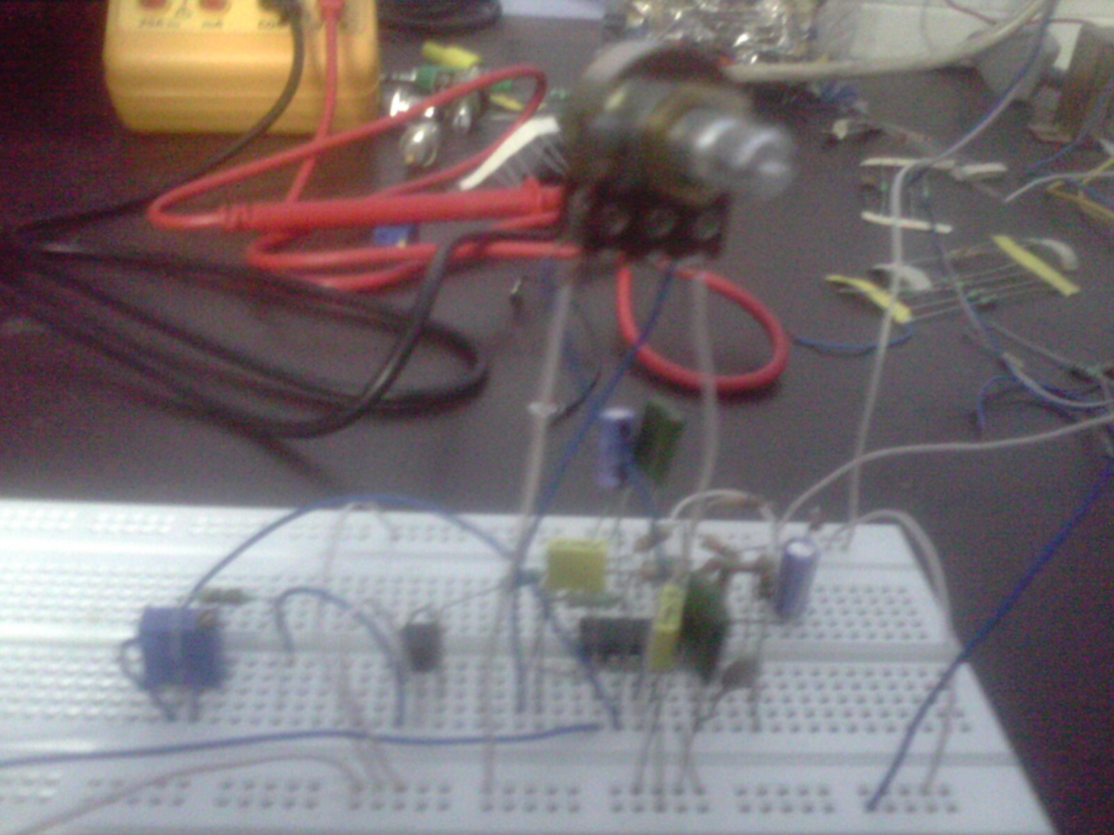

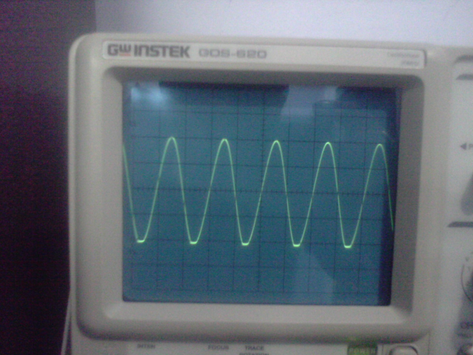

Last night I managed it to work but there are issues
1. Clipping occurs at negative swing and the swing is 20V pk-to-pk (which is very high).
2. Oscillation does not start until I vary potentiometer in Gain setting arm (connected in series with FET). I have to vary potentiometer each time.
I measured it's Vp (2SK104 = 1.26V), 2SK105 died during testing.
Is the Rdson resistance which we use to dimension the feedback network ?

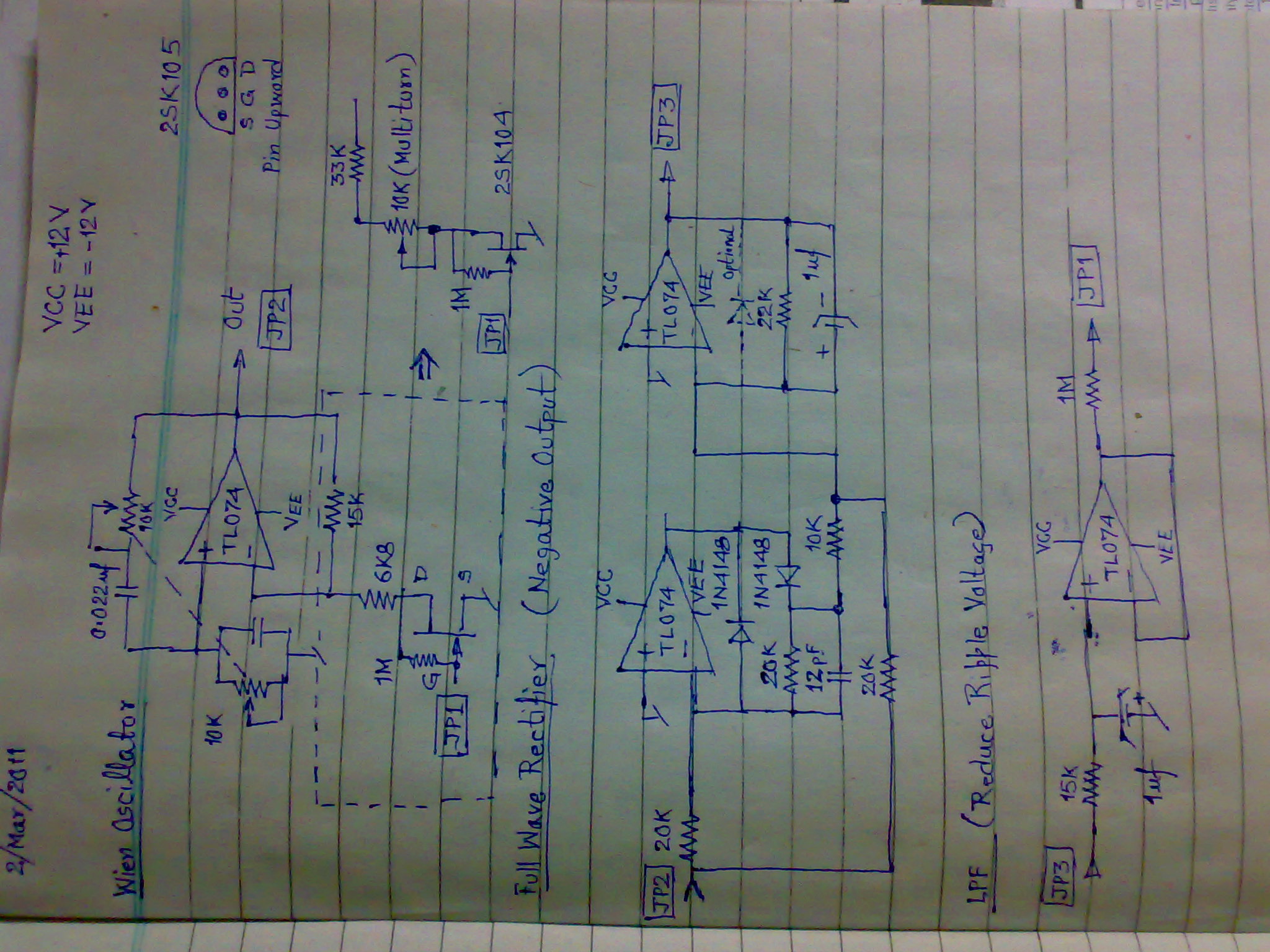

Sameer, the pictures you have presented are not very informative; more important: What is the actual circuit? (Bubba, Wien or something else?)
In particular, how does the negative feedback path looks like? Ootherwise, nobody can comment/evaluate your results.
Post #81: On 2/Mar/2011 I'll breadboard Wien with FET AGC.
I apologise. Here is the circuit.
Sameer, thank you.
Regarding the complete rectifier circuitry it is not easy to decide (without simulation) if it works properly.
But I have one recommendation: Check (measure/simulate)
(a) the gate control voltage vs. time,
(b) the drain voltage vs. time.
LvW: If you have time could you please simulate the circuit at your end.
I'll measure them tonight.

Sameer, at the moment, I can give you some general recommendations only because
(a) I have your fet not in my library and (b) because I leave for two days.
Recommendation:
*When the output amplitude is to large (clipping) the regulation mechanism must be activated at smaller amplitudes. That means, the N-JFET must operate (steady state) at a smaller voltage (magnitude) - equivalent to a smaller RDS,on. Therefore, the feedback resistor (15 k) must be reduced to keep the ratio of both resistive branches. Try this.
On the other hand, take care, that the signal voltage drop across the DS-path is not to large (not more than 50...100 mV max). From this requirement you can calculate the series resistor (presently Rs=6.8k) and a suitable feedback resistor.
*Example: With Rf=15k and Rs=6.8k the nominal RDS,on=15k/2-6.8k=0.7k.
With RDS,on=700 ohms and Rf=15k the voltage across DS is app. 4% of the output voltage.
That means for Vout=12 V (maximum) the voltage across DS is app 0.5 volts. perhaps a bit to large for a good THD.
* Check the FET characteristik in conjunction with the control voltage that is available after rectification
* Check the rectifier circuit separately with a sinusiodal input from a generator.
Good luck
Sameer,
I couldn`t find the datasheet for the selected FET, but I have tried to make some general considerations, which I think apply more or less to this FET type:
Ids,s=10 mA
Vp=-2 V.
The result is enclosed (Rds vs. V,gate). The applied drain voltage is Vds=0.5 volts.
It can be seen that the FET control voltage (at the gate) should be around (-1.6...-1.7)V and the corresponding resistance is app. (0.5...1) kohms.
The other areas are not well suited for control purposes (slope of the curve to large or to small, respectively).
Perhaps, this information can support your investigations.
