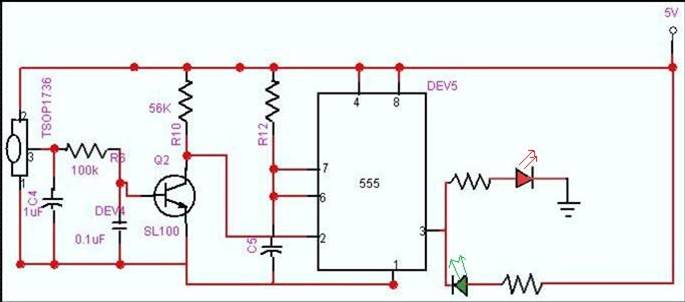

Hi, I am also using tsop1738. I am also facing problems. However the led in the reciver glows for a moment i get the IR led near the tsop1738 and then goes off again.I want the green led to glow as long as it gets IR signal. I even corrected my resistor values through the potentiometer by using 1.4K instead of the above 4.7K but still no use...Also the range is very small....plz help
Added after 1 minutes:
this is my circuit
